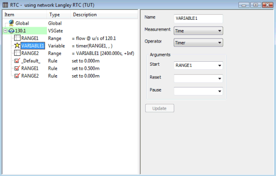

Timer
The Timer operator allows you to set up the variable as a timer. The value of the variable is the number of seconds since it was started (excluding pauses). The operation of the timer is as follows:
  • When the variable value is zero the timer is stopped.
  • When Argument 1 is TRUE the simulation will start the timer if it is not running.
  • When Argument 2 is TRUE the simulation will reset the timer variable to zero (stopping it running).
  • When Argument 3 is TRUE the simulation will pause the timer.
Arguments 2 and 3 may be blank.
