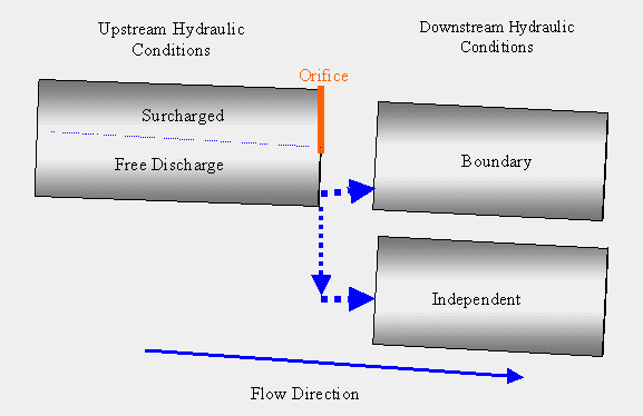

Figure 1 shows the up and downstream conditions. If the water level upstream of the orifice is below the soffit of the orifice, it is described as free discharge. If it is above the soffit, it is described as surcharged. If the water level downstream of the orifice is below the invert, it is described as independent. If it is above the invert it is described as a boundary condition.
Figure 1 Four Scenarios of Orifice Operation
- Free discharge and independent
- Surcharged and independent
- Free discharge and boundary
- Surcharged and boundary

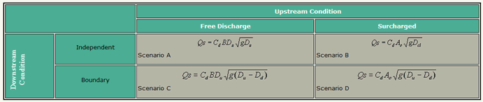

Each of these scenarios is described in Sections 2 to 5 below, including worked examples. Chapter 6 provides a summary of the equations used in each case.

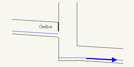

Figure 2 shows flow passing through an orifice before entering a manhole chamber. The flow freely discharges into the manhole chamber and there are no downstream conditions affecting the flow. The depth is below the soffit of the orifice and therefore the rectangular weir equation is used.
Figure 2 Free Discharge Upstream and Independent Downstream

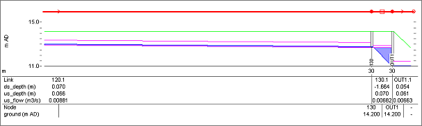

The network shown in Figure 3 was created to allow comparison between InfoWorks ICM and hand calculation under scenario A. In all worked examples, the diameter of the orifice is 150mm.
Figure 3 InfoWorks ICM Model of Scenario A
For Equation 1 (see Section 1):
Cd = 1
Ao = 0.0177 m 2
Do = 0.15 m
B = 0.0177 / 0.15 = 0.1178 m
Du = 0.07 (from Figure 3)
g = 9.80665 m/s 2
Therefore:
Qs = 1 x 0.1178 x 0.07 x (0.07 x 9.81) 0.5
Qs = 0.008246 x 0.8285321
Qs = 0.00683 m 3/s
This matches the flow in the orifice (link 130.1) shown in Figure 3.

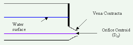

Where: Dcl = Height above the orifice centre |
(3) |

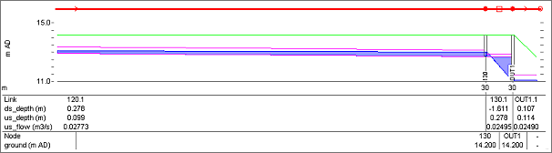

Figure 5 below shows a network where the upstream depth is greater than the orifice soffit.
Figure 5 InfoWorks ICM Model of Scenario B
From Equation 3:
A0 = 0.0177 m2
Dcl = 0.278 - 0.075 = 0.203
Where 0.278 is taken from Figure 5.
Therefore:
Qs = 1 x 0.0177 x (9.81 x 0.203) 0.5
Qs = 0.02493 m3
This matches the flow in Link 130.1, shown in Figure 5.

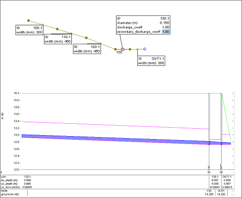

Figure 7 shows a simple 5 pipe network in plan and long section. The orifice is 150 mm in diameter and is connected to an upstream pipe with a diameter of 450 mm and downstream pipe with a 300mm diameter.
Figure 7 InfoWorks ICM Model of Scenario C
In scenario C, the equation used is similar to that of the rectangular weir:
From Figure 7:
Du = 0.098 m
Dd = 0.067 m
Therefore from Equation 4:
Qs = 1 x 0.1178 x 0.098 x (9.81 x (0.098 - 0.067)) 0.5
Qs = 0.0115 x 0.55136
Qs = 0.0064 m3

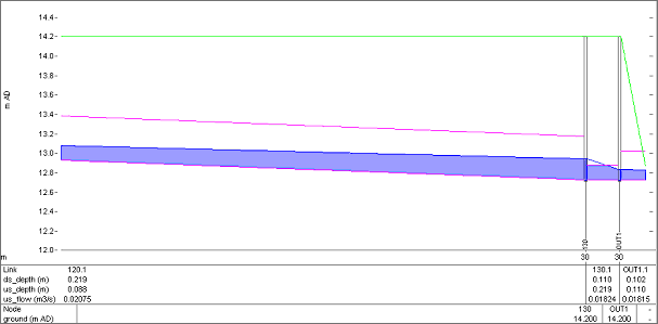

Figure 9 shows the same network as Figure 7. Here the flow rate upstream has been increased so that the orifice is surcharged upstream.
Figure 9 InfoWorks ICM Model of Scenario D
From Figure 9:
Du = 0.219 m
Dd = 0.110 m
Therefore from Equation 5:
Qs = 1 x 0.017671 x (9.81 x (0.219 - 0.110)) 0.5
Qs = 0.0176715 x 1.03389
Qs = 0.01827
Slight differences may occur due to the linearisation of the values when Du-Dd is less than 0.01.
6 Weir/Orifice Flow Check
An additional check for weir/orifice flow is also performed by ICM to distinguish between Scenarios C and D. Weir flow is still possible for an orifice if the following applies:
(6) |
In such cases, both weir flow and orifice flow are calculated by the ICM simulation engine, and whichever returns the lower value will be used in the simulation.
7 Summary
Table 1 presents a summary of the four combinations of upstream and downstream conditions including the equation which will be used in each case.
Table 1 Summary of Conditions and Equations
