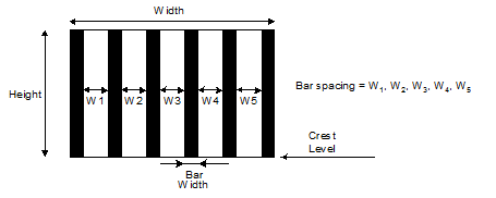

InfoWorks ICM allows sloping bar screens to be included in the network. A screen is used to trap debris in the network, possibly at the entrance to a treatment works.

C k is Kirschmer's Coefficient (representing bar shape)
α is the screen angle to the vertical
w is the bar width
S is the bar spacing

b is the width of the screen (including bars and bar spaces)
