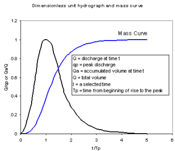

The SCS (Soil Conservation Service) unit routing model uses a curvilinear unit hydrograph to calculate runoff resulting from subcatchment net rainfall.
The SCS method uses a dimensionless unit hydrograph derived from the analysis of extensive measured data. For further information, see the FHWA-NHI-02-001 HDS2 Highway Hydrology Technical Report. Table 6.10 from the report listing discharge ratios for selected values of time ratios for the dimensionless unit hydrograph is reproduced as Table 1 below.

Table 1: Ratios for Dimensionless Unit Hydrograph and Mass Curve
Time Ratios t/Tp |
Discharge Ratios q/qp |
Mass Curve Ratios Qa/Q |
