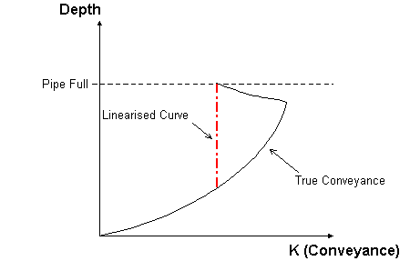

Don't linearise conveyance |
In culverts, the conveyance is greater just before the culvert becomes full than at the point when the culvert becomes surcharged. This effect is most pronounced in wide rectangular culverts, and occurs due to the effect of the roughness of the roof of the culvert. When this is option is unchecked (default), conveyance tables are linearised to the pipe full value to eliminate turning points in the conveyance function used by the solver. This is shown by the red line on the graph below. This results in the underestimation of flow capacity in rectangular culverts. However, it is more stable mathematically. When this option is checked, the simulation engine does not linearise conveyance tables (see the black line on the graph). Using this option may result in instabilities when the conduit enters/leaves surcharge.
Conduit Conveyance |
dont_linearise_k |
Boolean |
0 |
False |

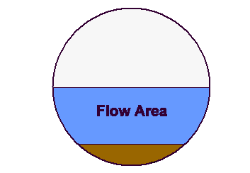

Use full area for headloss calculations |
By default the checkbox is unchecked. The value of velocity passed through to the headloss calculations is calculated from:
When this option is checked headloss calculations are carried out using the full cross section area of the pipe. |
