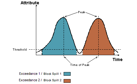

Peak <attribute> Time of peak (mins) Time of peak (absolute) |
Peak is the maximum value during the exceedance or maximum flow during the block spillage. Time of peak is the time at which the exceedance maximum or block spillage maximum occurs.

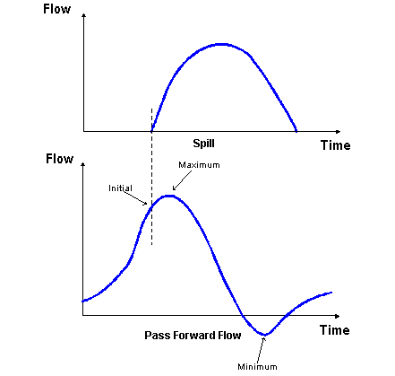

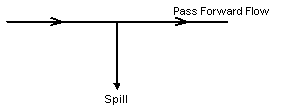

Pass forward link Initial pass forward flow Minimum pass forward flow Maximum pass forward flow |
The Pass forward link is the link specified in the Statistics Template grid.
The initial, minimum and maximum pass forward flows are identified as shown in the example below:

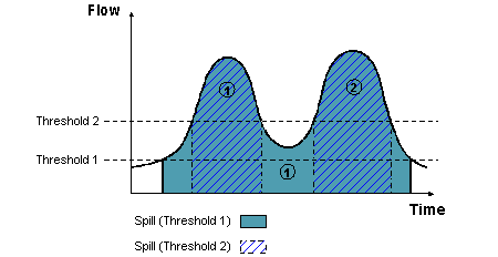

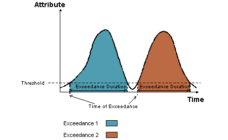

Exceedance count |
The total number of exceedances over Threshold that occur during the Simulation.

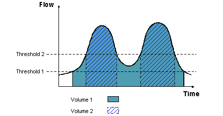

Click on the image below to display an example for the total number of spills over threshold that occur during the simulation. Example

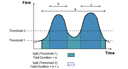

Total period of exceedances |
Sum of the time between the overall first and last times of spillage (threshold exceeded) within all the block spillages. Note that this is usually a larger value than the Total duration of exceedances as that corresponds to the total spillage time (i.e. sum of all durations where the threshold is exceeded) within all the spill blocks. |
Total duration of exceedances |
Sum of duration of Exceedances or block spillages over Threshold that occur during the simulation.
Click on the image below to display an example for the sum of duration exceedances of spills over threshold that occur during the simulation. Example
Note: Number of exceedances and therefore Total duration of exceedances will also be affected by the Combine events and Split long events options on the Stastistics Template View. |

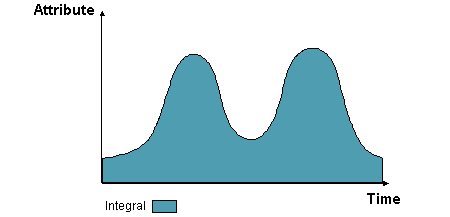

Total integral |
Sum of exceedance areas under Attribute vs Time graph.
Click on the image below to display an example of the sum of spill volumes throughout simulation. Example
Note: Number of Exceedances and therefore Total integral will also be affected by the Combine events and Split long events options on the Stastistics Template View. |
