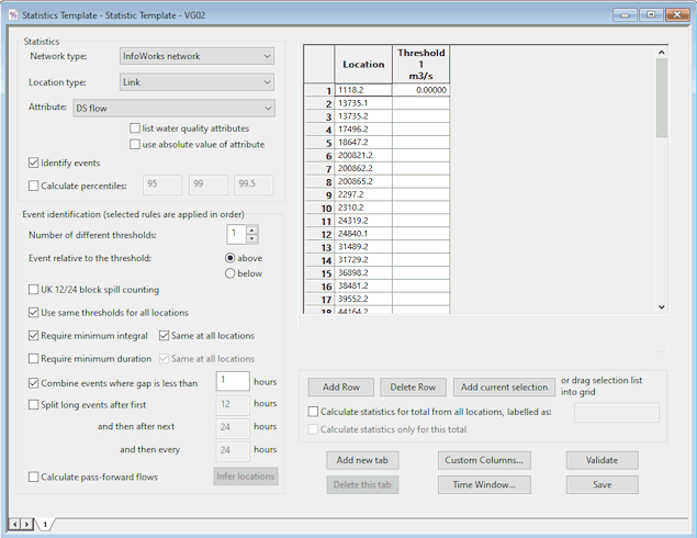

Statistics Templates
Statistics templates are used to specify the locations and attributes for which statistical summary data is to be produced. The summary data is displayed in Statistical Reports.
To add a new statistics template, right-click on a Model Group, and select either New InfoWorksStatistics template or New SWMMStatistics template from the popup menu.
Existing statistics templates can be opened by right-clicking on the template and selecting Open. Note that a statistics template cannot be edited or deleted after it has been used to generate statistics.
Statistics Template dialog
For each combination of Location type and Attribute, you can specify whether to report on events and/or percentiles. Up to three percentiles and up to three event thresholds may be defined. There are a number of rules which may be applied when reporting on events (see Event Identification Section below for more details). Selected locations are displayed in a grid.
In addition, a period of time (time window) or a set of regularly recurring time windows may be specified via the Time Windows Dialog. Data used to derive statistics will be restricted to those results which fall within the specified time window.

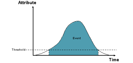

Event is the period above / below the threshold
Radio buttons to select whether to report on events occurring above or below the threshold value defined in the Statistics Template Grid

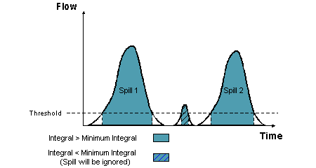

Require minimum integral
Check this box to define a minimum integral value in the Statistics Template Grid. Exceedances and block spills above/below the Threshold value that do not meet this minimum will be discounted as an event and will be ignored.

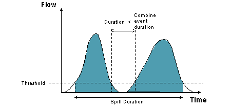

Combine events
Check this box to combine events in cases where there is a short duration between events. Specify the duration in hours between events. Combined events are treated as one event in the Statistical Report.
This option is disabled if the UK 12/24 block spill counting box is checked.

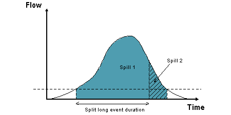

Split long events
Check this box to divide long events into a number of events. Specify the duration in hours when an event should be split.
Note: Rules are applied in order and are not re-applied after a long event is split. Therefore it is possible that an event that has been split may be less than the minimum integral / minimum duration.
The statistics template grid displays the objects to be reported on in the Statistical Reports. The grid can be populated in three ways:
  1. Drag a saved selection list into the grid
  2. Highlight a selection in the GeoPlan and click Add current selection
  3. Type in object ID into Location column
For InfoWorks networks, it is recommended that links which are selected for analysis should be modelled with a gauged timestep as opposed to a results timestep (see the Hydraulic Run View). This will improve the accuracy of the results.
The columns displayed in the grid will vary depending on the Event Identification rules selected.

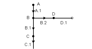

Pass forward location
Click the Infer Locations button to automatically populate the Pass Forward Location. (See example below)
If D.1 is the Location, Infer Locations will search upstream from D.1 until a node with two outgoing links is found (node B). Link B.1 will be identified as the Pass Forward Location. If there is more than one possible pass forward location, the link with the lowest suffix will be chosen.
Note: It is not possible to define two different pass forward locations relating to the same spill location in the same template.
Threshold
Attribute value
(Constant y value on graph of attribute against time)
Event occurs when attribute value (e.g. flow) crosses Threshold line (if all Event Identification rules are satisfied)
Integral
Minimum Integral of an Exceedance or block spill. If the Integral of an Exceedance or block spill is less than the Integral value specified, the Exceedance will be discounted as an event and will be ignored.
e.g.
Tip: A integral of 50 m3 would normally be used with the UK 12/24 block spill counting method.
