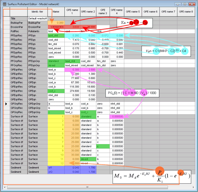

To display the Surface Pollutant Editor for the current network, click on the Surface Pollutant Editor icon ( ) from the Modelling Grid Windows toolbar.
Editor Layout
The editor displays a series of records (rows on the grid).
The surface pollutant parameters can contain the following record types, which must be entered in the order listed, with one or more of each type of record:
  • Title record
  • Buildup Parameters Record
  • Erosion Parameters Record
  • Pollutants Record
  • Potency Factor Equation Record
  • Potency Factor Equation Group Record
  • Gully Pot Equation Record
  • Gully Pot Equation Group Record
  • Surface Definition Record
  • Sediment Record
The Sediment Fraction parameters are always defined in the bottom rows of the editor. You can add a maximum of two Sediment Records below the last Surface Definition Record.
The buildup and erosion parameters are defined in the first two rows below the title.
The rest of the editor is dedicated to defining Pollution Indices. The final definition of a Pollution Index is given in a Surface Definition Record. This brings together other data and equations defined in previous records.
The image below shows an example. Click on a row in the image to go to information about each record type and the fields they contain. Use the Back button to return to the image.
Image Key
Related parts of the image are highlighted in the same colour. The arrows show the relationship between values defined in the editor and parameters in the equations used in the model.
Cell Colour
Explanation
This colour indicates the ID fields for the Pollution Indices. There are 12 defined in this network. You can have a maximum of 99, with numeric IDs between 1 and 99.
This colour shows the parameters for the Surface Buildup Equation. The block of values in the lower half of the view are the Surface Buildup Factor parameters defined for each Pollution Index in the Surface Definition Record.
This colour shows the Surface Erosion Equation parameters. These are all defined in the Erosion Parameters Record.
This colour shows the Potency Factor Equation parameters. You define a set of parameters for each equation. You need at least one equation for each pollutant being modelled.
The green cells show the links between the different records in the editor. Look for matching names to see how equations are added to groups and groups included in Pollution Indices.
This colour shows the parameters for the Gully Pot Equation. You do not define gully pot value (V g) directly. Enter a value for the gully pot depth for each Pollution Index. This is then multiplied by the area of Runoff Surface 1 from the Land Use to give gully pot volume. By convention, Runoff Surface 1 is the road surface.
These are the parameters defining the sediment fraction characteristics.
