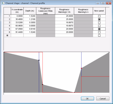

Data Group C2, C3, C4 - Irregular Channel Data
The importer creates channel shapes for conduits of type NKLASS=8 (irregular) channels. The data required to create the channel cross-section are in Data Groups C2 - C4.
Show me

Data Group C3 - Cross Section Data
SWMM4
Description
Conversion Notes
SECNO
Cross Section ID
Used as a cross reference to conduit data in Data Group C1
NUMST
Number of stations on the cross section
Number of entries in Cross-Section Shape grid
STCHL
Station of left bank of channel
Position of left bank panel marker
STCHR
Station of right bank of channel
Position of right bank panel marker
XLOBL
Not Required. Enter 0.0
Not Used
XLOBR
Not Used
LEN(N)
Length of channel reach represented by cross section
Length of section
PXSECR
Multiplication Factor to modify horizontal dimensions of cross section
Multiplies X Co-ordinates by PXSECR value
PSXECE
Constant to be added to cross section elevation data
Not used
Data Group C4 - Cross-Section Profile
SWMM4
Description
InfoWorks ICM Data Field
EL(i)
Cross Section elevation at Station (i).
Depth
STA(i)
Position of Station number (i)
X Coord.
