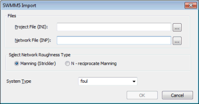

This dialog is used when
Importing SWMM5 Network Data, and is displayed when Import
Model
from SWMM5 text file is selected from the Network menu.
The items which comprise this dialog are described in the following table:
Item |
Description |
| Project File (INI) |
The name of the .INI file to be imported (optional). The path to the text file to be imported can be specified in the Project File (INI) field, or alternatively, you can use the browse button to select a file from a Windows File Open dialog. |
| Network File (INP) |
The name of the .INP file to be imported. The path to the text file to be imported can be specified in the Network File (INP) field, or alternatively, you can use the browse button to select a file from a Windows File Open dialog. |
| Selecting Network Roughness Type |
As SWMM5 uses the Manning equation to represent roughness, this box is used to determine if Manning values will be represented in InfoWorks ICM as either M = 1 / n (Manning (Strickler)) or n (N -reciprocate Manning). |
| System Type | The network system type that the imported data applies to can be selected from the dropdown list. |
| OK | Starts the import of the SWMM5 data. |
| Cancel | Cancels the SWMM5 import operation. |
For further information about using this dialog to import the data, see the Importing SWMM5 Network Data to InfoWorks Networks topic.
