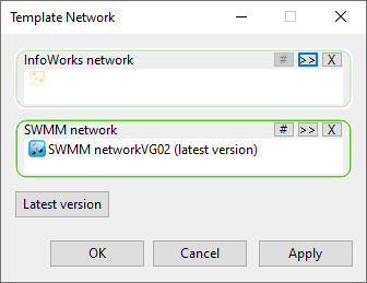

  1. Select the Template network option from the Tools menu.
  2. The Template Network dialog is displayed
    Template Network Dialog
  3. Drag an existing InfoWorks network from the tree view in the Explorer window to the InfoWorks network drop target in the dialog or drag a SWMM network to the SWMM network drop target. Alternatively, use the (Browse) button in the applicable drop target to search for the relevant network from the Common Tree Selection dialog.
    If a network has already been selected to be used as the template, ie, its name is already displayed in the drop target, then this will be replaced when the new network is dropped into the target box.
    • If you want to use a particular version of the selected network, select the (Version) button to search for it. A Select Commit dialog is displayed from which you can select the required version.
    • If you want to always use the latest version of the selected network, click on the Latest version button. This ensures that any new networks will be based on the latest committed version of the template networks, regardless of the versions currently selected.
  4. Click on OK to save the changes.
To delete a template network, select the (Delete selection) button in the applicable drop target. Any networks which were created using the deleted template network will not be affected by the change.
