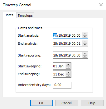

This dialog is displayed by clicking the Timestep control button in the SWMM Schedule Hydraulic Run View.
Dates tab in the Timestep Control dialog
It is used to define the:
  • start and end dates/times of a simulation on the Dates page.
  • length of the time steps used for runoff computation, routing computation and results reporting on the Timesteps page. This page is also used to identify and treat periods of time when the hydraulic network is considered to be in a steady flow.
Dates page
Start analysis The date (month/day/year) and time of day when the simulation begins.
End analysis
The date (month/day/year) and time of day when the simulation ends.
This must be on or after the Start analysis date and time.
Start reporting
The date (month/day/year) and time of day when reporting of simulation results is to begin.
This must be on or after the Start analysis date and time, and on or before the End analysis date and time.
Start sweeping The day of the year (month/day) when street sweeping operations begin. The default is January 1. This value is used when calculating the pollutant build up.
End sweeping The day of the year (month/day) when street sweeping operations ends. The default is December 31. This value is used when calculating the pollutant build up.
Antecedent dry days The number of days with no rainfall prior to the start of the simulation. This value is used to compute an intital buildup of pollutants on the surface of subcatchments.
