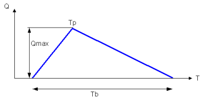

A Unit Hydrograph for the subcatchment is determined from user defined parameters, or from parameters calculated by built in methods. The Unit Hydrograph is then used to calculate runoff resulting from the subcatchment net rainfall.
The Unit Hydrograph parameters are specified in the Subcatchment Grid Window of the Subcatchments Grid or in the Unit Hydrograph Routing Definiton section of the Subcatchment Property Sheet.
The following data is required in order to define the Unit Hydrograph:
- Tp - time of peak flow
- Tb - total runoff time
- Qmax - maximum flow
Tp and Tb can be defined individually for each subcatchment. Alternatively, Tc, the time of concentration can be used to compute Tp and Tb. The time of concentration is the longest time required for a particle to travel from the watershed divide to the watershed outlet.

For unit hydrograph definitions except Rational, if Tc is defined or calculated, Tp and Tb are calculated as follows:
Where: Tp is the time of peak flow Tc is the time of concentration, or the subcatchment response time
fts is the timestep factor ftp is the time to peak factor (The timestep factor and the time to peak factor are user-defined variables and depend on the method chosen for defining Tp from Tc, except for the SCS-User-Tc hydrograph, where fts is set to zero and ftp is set to 2/3.)
Total runoff time, Tb, is calculated from Tp.
For unit hydrograph definitions except SCS-User-Tc:
For unit hydrograph SCS-User-Tc:
Qmax is then calculated via simple geometry:
For Rational unit hydrograph:
