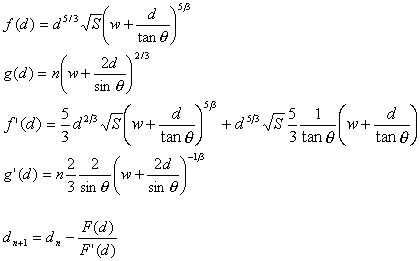

The flow is therefore written as:
(13)
which can be solved for d using an appropriate non-linear equation solver. A Newton-Raphson method has been implemented in InfoWorks ICM.
(14)
Newton-Raphson requires the solution of the following equation:
(15)
where:
(16)
This has been implemented with a default depth estimate of 1.0 m for the first sub-reach. Subsequent sub-reaches use the depth from the previous sub-reach as the initial estimate.
