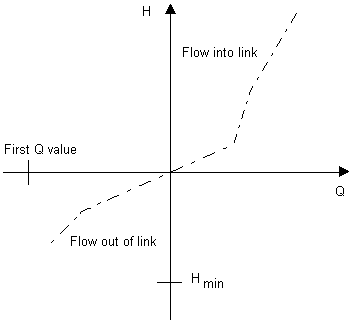

Vortex Control
This control is similar to the compound weir, but has different characteristics for the two directions of flow.
A vortex control is represented as a link of zero length, forming a head-discharge relationship between two nodes. The boundary condition between the link and a node is that of equal water levels. The vortex invert level determines when the control first comes into operation.
A modular limit can be set for a vortex control, which uses the upstream depth to determine the free-flow from the head discharge table. A drowning factor is applied to the flow if the ratio of downstream depth to upstream depth exceeds the specified modular limit. The equations used to find the flow characteristics when a modular limit is applied is described in the Modular Limit section.
Flow Characteristics
When no modular limit is specified, the flow characteristics for the physical behaviour differ in the positive and negative directions and contain a hysteresis loop, the path through which depends on the direction of movement along the curve.
The governing model equation assumes the above linearisation of the hysteresis loop, resulting in a unique discharge for a given head:
Q = f(h)
where
Q - Discharge (m3/s)
f(h) - User-defined function
h - Head across vortex (m)
and under free discharge conditions the head is equal to the upstream depth Du, whereas under drowned conditions the difference is Du - Dd between upstream and downstream.
The overall relationship between discharge and head in both directions is represented as a data table of up to 15 discharge values at head values equally spaced by a specified increment. Intermediate values are interpolated linearly from the table. The discharge corresponding to a head outside the bounds of the table is determined by extrapolation.
