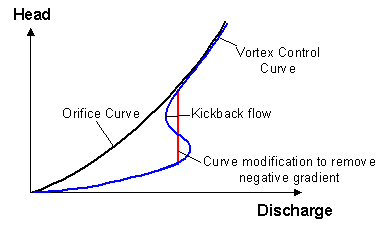

E2258
Less than previous value
Info
Head Discharge ID
Cause
Applicable to objects with associated Head Discharge curves except for pumps of Link Type = ROTPMP:
Discharge values in the Head / Discharge Grid are in descending order i.e. type = Head descending (ROTPMP).
Advice
Check that the correct Head / Discharge Grid is associated with the object. Change Head / Discharge Grid to type Head ascending if necessary.
When modelling a vortex control, modification of the head discharge curve is required to remove the negative gradient in the kickback flow region.
Suggested modification to vortex control curve
