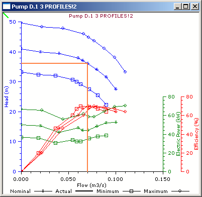

Analysing Pump Operation
The operation of a variable frequency drive pump can be analysed by graphing the curve for the pump including display of all the operating points for the pump during the simulation.
To display a graph of pump operation:
- Open simulation results in a GeoPlan Window
- Click on the pump to be analysed using the Pick Graph
tool. The
Graph Pick Selection Dialog will be displayed.
- Select the Pump Operation option from the Graph Pick Selection Dialog. A graph of pump operation will be displayed. The graph displays curves for minimum and maximum speed as well as for actual speed.
Pump Operation Graph
