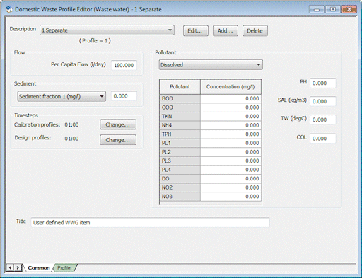

Common Page
The Common Page of the Domestic Waste Profile Editor and the Trade Waste Profile Editor allows viewing and editing of fixed parameters for a chosen profile.
The profile to be viewed / edited can be changed by using the Description dropdown list.
Description
Use the profile dropdown list to select the profile to be viewed or edited.
Use the Add button to add a new profile. The Add Wastewater Profile Identifier Dialog will be displayed. Enter a profile name and ID in the dialog. The limit is 999 profiles.
Use the Edit button to change the profile name or ID.
Use the Delete button to remove the profile.
Profile ID
To change the profile ID, click the Edit button and change the ID on the Add Wastewater Profile Identifier Dialog.
Title
A description of the profile, up to 80 characters
Per Capita Flow (Domestic)
Applicable to Waste Water Events only.
The average wastewater flow per person. This can be any value from 0 to 100000. The background colour of the box will change to red if the specified value is outside this range.

Timesteps
Timestep intervals used for the 24 hour calibration and design profiles defined on the Profile Page.
Click the Change buttons to edit the timestep. The Select Profile Timestep Dialog will be displayed. The timestep may be specified in hours or minutes. The timestep must be an exact fraction of one day and if specified in minutes must not exceed 96 minutes.
The default timestep is 1 hour.

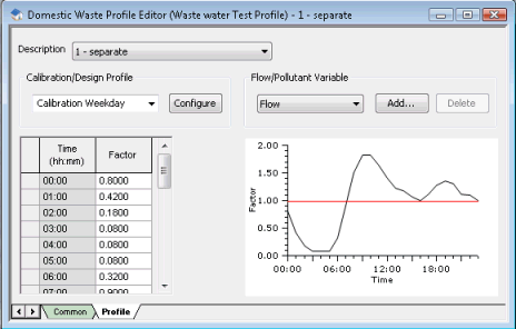

The Profile Page of the Domestic Waste Profile Editor and the Trade Waste Profile Editor allows viewing and editing of the time varying multiplier profiles applied to nominal flow or pollutant values to produce a time varying wastewater, trade flow or pollutant profile.
Description
Use the profile dropdown list to move between profiles.
Profiles can be added, renamed or deleted on the Common page.
Calibration/Design Profile
Use this dropdown list to select the multiplier profile currently being viewed and edited.
By default each domestic / trade waste profile has Calibration Weekday, Calibration Weekend, Calibration Monthly and Design profiles applied to it.

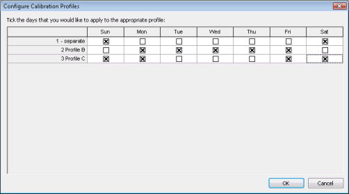

To add further specific day of the week calibration profiles:
  • Click the Configure button. This will display the Configure Calibration Profiles Dialog.
  • Check the boxes for the days of the week required for each domestic / trade waste profile and click OK.
  • The calibration profile for each of the days of the week selected will be made available for editing in the dropdown list.
    Note: Selected day of the week calibration profiles will be applied to both the Flow and Pollutant variables of the event profile.

Profile Grid
Use the grid to view and edit the profile values for the profile selected from the Calibration/Design Profile dropdown list
Graph Display
The graph displays the profile values for the profile selected from the Calibration/Design Profile dropdown list
