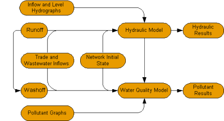

The diagram below shows how the various parts of the InfoWorks ICM simulation engine interact. Hydraulic modelling aspects are at the top of the diagram. Water quality aspects are at the bottom. Shared aspects are in the middle.
Structure of the Water Quality Model
The diagram is intentionally symmetrical. Every aspect of the hydraulic model has an equivalent area in the water quality model.
The diagram shows that the Runoff Model and the Hydraulic Model provide information for their water quality equivalents, but there is no feedback from the water quality side to the hydraulic modelling.

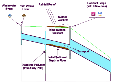

Water Quality Determinants and sediment can enter the model from a number of sources. The diagram below shows the various components of the model.
Components of the Water Quality Model
The water quality model carries out its calculations in three stages for each timestep:
  1. The Network Model calculates the concentration of dissolved pollutants and suspended sediment at all nodes using a Conservation of Mass equation
  2. The Conduit Model calculates the concentration of dissolved pollutants and suspended sediment along each conduit
  3. The Conduit Model then calculates the erosion and deposition of sediment in each conduit
Dry Weather
  • Sediment will build up and reach a steady state on the catchment surfaces
  • A layer of active sediment will build up in conduits. This active sediment can be transported by flows in the network. Active sediment sits on top of a fixed layer of bedded sediment that does not change during the simulation. See Sediment.
  • Inflows of sediment and pollutant that follow a 24 hour pattern can come from areas of population (wastewater event) and industrial sources (trade event). See Trade and Wastewater Events.
  • Inflows of sediment and pollutant that do not follow a 24 hour pattern, such as weekly tank flushing at an industrial plant, can be applied using a pollutant graph associated with an inflow hydrograph. See Pollutographs.
Storms
During a storm event, the dry weather inputs will continue.
  • Rainfall will generate runoff from the catchment into the network. This, in turn, causes sediment to be eroded from the catchment surface and washed into the network
  • Dissolved pollutants are also flushed into the system by surface runoff
  • Increased flow in the network causes an increase in erosion and transport of sediment through the network.
