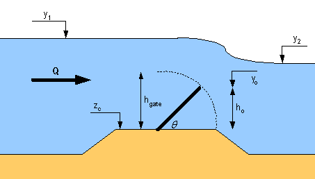

Gated Weir

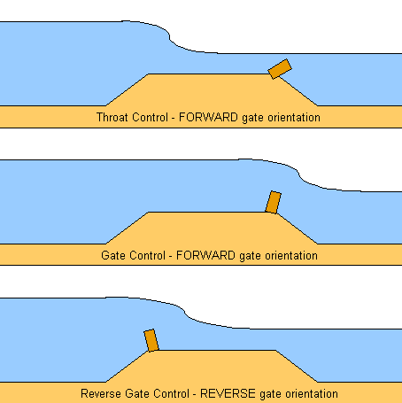

Three flow regimes can be used to model for flow over a gated weir:
- when the gate is lowered and the weir operates as a flume or broad crested weir with critical depth in the body of the structure.
- when the gate is raised and critical depth occurs at the gate crest.
- when the direction of flow is from the free crest towards the hinge when performance is similar to a weir with a triangular profile.
These are shown on the diagrams below:
Equations
Gated Weir Parameters
If the level on both sides is below the gate crest, then the following equation is used:
Equation |
Q = 0 |

Reverse flow combinations
The equations and conditions are the same as for the forward flow combinations (described above) but with reverse flow (Q<0). Note that the orientation of the gate specified for reverse flow combinations is relative to the crest, not the flow direction, e.g. for 'Free weir flow - reverse gate, throat control, reverse flow', the position of the gate is not physically oriented the same as for 'Free weir flow - throat control'. For 'Free weir flow - throat control' and 'Free weir flow - forward gate control, reverse flow', the gates are in the same position, relative to the crest.
- Free weir flow - reverse gate, throat control, reverse flow
- Drowned weir flow - reverse gate, throat control, reverse flow
- Free weir flow - reverse gate control, reverse flow
- Drowned weir flow - reverse gate control, reverse flow
- Free weir flow - forward gate control, reverse flow
- Drowned weir flow - forward gate control, reverse flow
