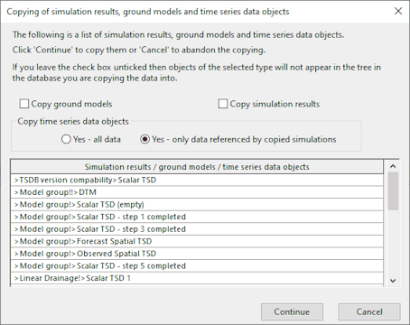

Copying of Simulation Results, Ground Models and Time Series Databases Dialog
Example of dialog when an item containing one or more simulations, ground models and time series data objects is being copied.

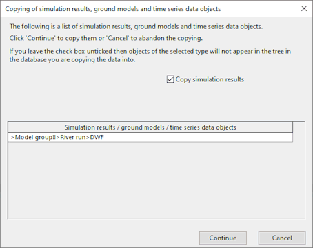

Copying of Simulation Results Dialog
Example of dialog when an item containing one simulation is being copied (no ground models or time series data objects)

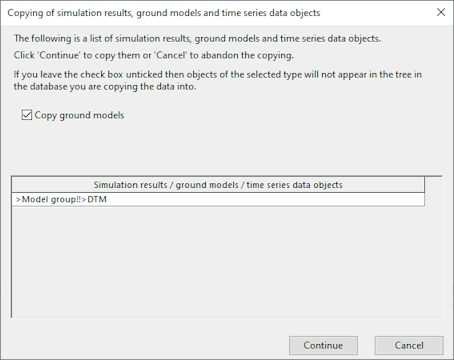

Example of dialog when an item containing one ground model is being copied (no simulations or time series data objects)

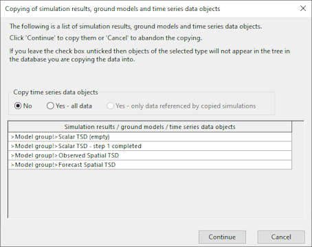

Copying of Time Series Databases Dialog
Example of dialog when only time series data objects are being copied (no simulations or ground models)
