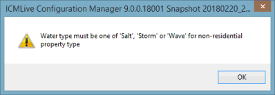

    InfoWorks ICM checks that all the selected import options are applicable for the type of property being imported.
    A message, similar to the one shown below, will be displayed for the first invalid import option it finds:
    Invalid Message Example
    Click on OK to close the message window and then, in the Import 2017 MCM Damage Curves dialog, change either the import option or the property type as appropriate, and click on OK.

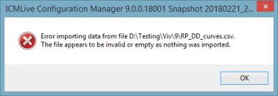

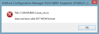

  9. Click OK to import the damage curve data. InfoWorks ICM checks that the file to be imported contains data in the correct format, and if it does not, a message, similar to the one below, will be displayed:
    Invalid Message Example 3
    Click OK to close the window. Check that the correct import files are available and start the import process once more.

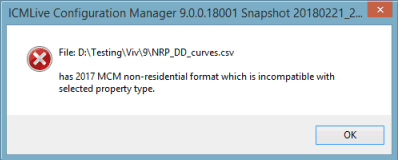

    • The csv files contains data for the selected type of property and not, a message, similar to the one below, may be displayed:
      Invalid Message of Wrong Property Type
      Click OK to close the message window. Check that a file that contains non-residential data is available if the Non-residential properties radio button has been selected, or a file with residential damage data is available if Residential properties was selected, and then start the import process once again.

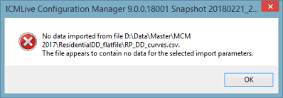

    • The file being imported contains data that is relevant for the selected import options, and if it does not, a message, similar to the one below, will be displayed:
      No data imported message
      Click on OK to close the message window. Start the import process once more, ensuring that the correct options are selected for the selected type of property.

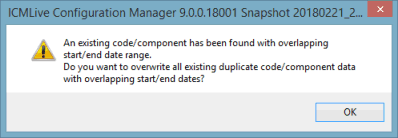

    • The selected residential or non-residential csv file being imported does not contain the same data that already exists in the Damage Function it is being imported into. If it does a message, similar to the one below, may be displayed:
      Invalid Message - Duration
      Select No to keep the existing data or Yes to import the new data. If Yes is selected, the existing data is deleted and the imported data is added to the applicable Damage Function. If any other files being imported also contain duplicate data, then the existing data will be automatically overwritten.

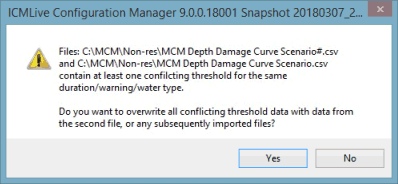

    • The values in the selected duration csv files are not being imported into existing thresholds with the same values in the Damage Function. If they are, a message, similar to the one below, may be displayed:
      Invalid Message - Threshold
      Select No to keep the existing threshold data or Yes to import the threshold data from the file currently being imported. If Yes is selected, any duplicate threshold data will be automatically overwritten by data in any files subsequently imported. Note that if, for example, 3 duration files are being imported into a Damage Function that currently contains no threshold data, then the first file will be imported. When the second file is being imported, InfoWorks ICM will check if it contains any threshold information whose values are the same as in the first imported file, and if it does, a message similar to the previous one will be displayed.
