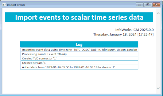

- If you want to import the events' initial conditions, drag an empty Catchment initial conditions object into the Also import initial conditions to drop target.
- When finished, click OK. The dialog closes and a report is displayed, listing the results of the import:
- Close the report.
