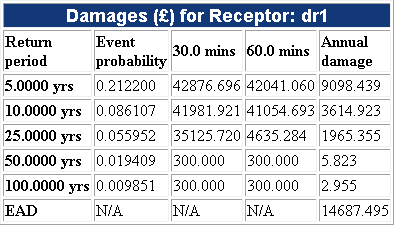

Tables of damages
Column Description
Return period Return period of rainfall event
Event probability
Probability of event occurring.
The probability of non exceedance of a given return period is calculated using:
where:
RPi is the return period under consideration.
The Event probability is calculated by discretising the probability of non exceedance curve, where the Largest zero-damage event return period, specified in the Risk Analysis Run View gives the probability for zero damage.
For example, for a risk analysis using events with return periods 2, 5, 10, 25, 50 and 100 and a largest zero-damage event return period of 2:
Return Period
Probability of non exceedance
Pi=e-1/RPi
Event probability
2 0.606531
5 0.818731 0.212200
10 0.904837 0.086107
25 0.960789 0.055952
50 0.980199 0.019409
100 0.99005 0.009851
Event duration Worst case damage calculation values for each storm duration for given return period.
Annual damage Annual damage for a return period is calculated by multiplying the largest of the damage values for that return period by the Event probability for the return period.

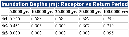

Table of inundation depths
Note that any blank fields in the inundation depths table indicate that there is no maximum depth.
The event duration giving the maximum depth for each return period may not be the same as the event duration giving the maximum damage.
A depth/probability of non exceedance curve for each Damage Receptor is calculated as follows:
  • Sort the table of return periods by the maximum depth value for all event durations for each return period.
  • Convert into a cumulative distribution function by summing the band probability of occurrence.
The inundation depths presented in the table for each return period are determined by interpolating the values at the probabilities corresponding to the originally simulated return periods, (value calculated by ).
For example:
Return Period Depth
Band probability
(Event probability calculated in table of damages)
2 0 0.606531 0.606531
5 0.12 0.009851 0.616382
10 0.15 0.212200 0.828582
25 0.17 0.086107 0.914689
50 0.18 0.055952 0.970641
100 0.2 0.019409 0.990050
