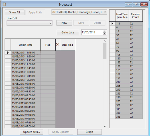

An example of a configured spatial TSD

To configure a Spatial TSD object
- Create a new Spatial TSD database item.
- Drag the spatial TSD object from the
Explorer window and drop it onto the GeoPlan or the main window.
The Spatial time series data configuration dialog is displayed.
- Configure the import as appropriate (See the Spatial time series data configuration dialog for more information).
- When finished, click OK.
- The Time Series Data grid is displayed.

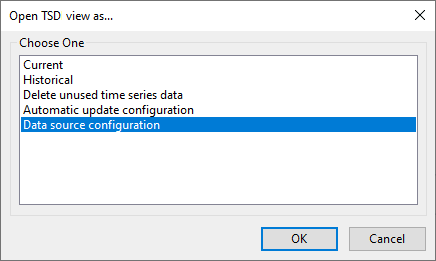

To open the Data Source configuration setting for a Spatial TSD object
- Right-click a Spatial TSD object in the Explorer Window and select Open As from the context menu.
- Select the Data source configuration option from the Open TSD view as dialog.
- Click OK.
- The Spatial time series data configuration dialog is displayed.

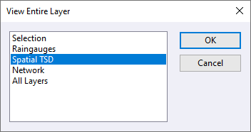

Zoom to a Spatial TSD on the network
You can zoom to a Spatial TSD on a network that is currently open on the GeoPlan. To do so:
- Ensure that the relevant network is opened on the GeoPlan.
- Drag a Spatial TSD object from the Explorer window and drop it on the network in the GeoPlan.
- Right-click on the GeoPlan and select View entire GIS layer from the context menu.
A View Entire Layer dialog, similar to the one shown below, is displayed:
- Select the Spatial TSD option from the list.
- Click OK. The dialog closes and the GeoPlan zooms in on the applicable area of the network.
