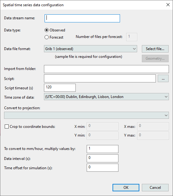

Spatial Time Series Data Configuration Dialog

This dialog is displayed when a newly created and empty Spatial Time Series Data object is dropped onto a GeoPlan or the InfoWorks ICM background, or when the Open as option is selected from the context menu of a previously configured Spatial time series data object.
It lets you configure the selected Spatial time series data object.
Spatial time series data configuration dialog
Dialog description
Option Description
Data stream name
User-defined name for the data stream.
Data type
Observed or Forecast.
If Forecast is selected, it is possible to specify the number of files in the Number of files per forecast box.

Select file Clicking this button displays a standard Open dialog allowing selection of one file. Only one file is required to set up the data template.
Geometry
This button is enabled when the ASCII Grid or Binary Grid is selected from the Data file format dropdown list, and a suitable file (such as RADAR rainfall data) has been selected using the Select file button.
Click this button to display the Spatial TSD Geometry dialog or the Spatial Rain Raw Binary File Configuration dialog which is used to specify file information and grid parameters for the selected file.
Import from folder
Populated once a file is selected using the Select file button.
Note: The absolute path and folder name, rather than a mapped drive, must be specified. Therefore, edit this field if necessary.
Script
Absolute path and name of the script file, plus any script parameters, which will be run at the start of the data update process.

Script timeout (s)
Interval of time after which the script is deemed to have failed.
Time zone of data
Allows users to select the time zone of the data.
Default is UTC as most data is provided in that time zone.
Convert to projection
Defines the GeoPlan projection.
If required, use this option to set the GeoPlan projection system to be the same as the projection system the live data is in.
Crop to coordinate bounds
Enabled by default when a GeoPlan is opened.
When enabled, this option allows users to reduce the size of the rainfall data to a bounding rectangle whose size can be set using the X min, X max, Y min and Y max fields.
This option is particularly useful in the case of large images as it reduce the amount of data loaded to the area of interest.
Tip: The cropping area is set to the area visible in the Geoplan when a GeoPlan window is opened at the time of the configuration. The values can then be changed manually by the user.
To convert to mm/hour, multiply values by
Multiplying factor used to convert the data to mm/hour.
Data interval (seconds)
Time interval between successive observations or successive images in a forecast. The purpose of this field is to make InfoWorks ICM aware that an image or value was expected a particular time, but is missing or has not yet arrived. This is particularly important when data is combined from multiple sources (in a TVD connector or spatial rainfall).
Time offset for simulation (seconds)
An image has a time stamp at the end of the interval over which the rainfall was measured. For example, an image with a data interval of 15 minutes and a time stamp 10.15 might have been measured during a radar sweep between 10.00 and 10.15, and so it represents the average rainfall rate in the interval 10.00-10.15. For the simulation engine, this value needs to be given a time stamp of 10.00, as the engine applies rainfall values starting at the specified time and continuing until the next value. Thus the offset that needs to be applied is -15 (minutes). Typically, but not necessarily, the offset will be the negative of the data interval (i.e. shift back from end-of-interval to start-of-interval).
OK
Commit the changes and close the dialog.
Cancel
Abort the configuration process and close the dialog.
