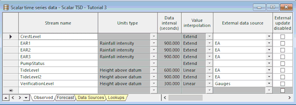

Scalar TSD
An example of a configured scalar TSD

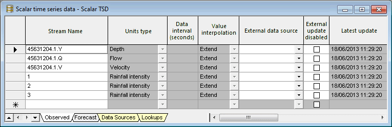

The Observed and Forecast pages contain information about observed and forecast streams respectively. The Data Sources page contains details of the corresponding external sources while the Lookups page is used to map alphanumeric text, in the imported time varying data, to numerical values which are recognised by InfoWorks ICM.
There are two types of stream: observed and forecast. Observed streams record real world measured values whereas forecast streams record predicted values.

The following stream properties apply to both observed and forecast streams unless otherwise stated:
Field Description
Stream name
The data stream name.
When using Simple CSV format as the data source type, the data stream name will be used to identify the file containing the live data feed by default.
When using FW Format1 (FloodWorks Data Transfer File Format 1) as the data source type, ensure that each individual data stream in the multiple stream FloodWorks file is assigned to a single stream name in InfoWorks ICM.
Units type*
The type of data measurement.
Data interval*
The expected maximum time interval between successive values. This is used to determine if values are missing at any given time. If each value is valid indefinitely (until superseded by a later value) then set this to 0.
Value interpolation
The value interpolation method defines how values are interpolated when needed at times in-between non-missing values. The options are:
  • Extend - a step function will be used between non-missing values
  • Linear - linear interpolation of values will be carried out between non-missing values
Note that the engine will always use Extend for Rainfall, even if the method has been set to Linear, and will always use Linear for other items e.g. flow, level. The Value interpolation only applies if interpolation is needed when generating the data sent to the engine, for example when you have two flow profiles to go into the event file, but these have different time steps and so must be interpolated to a common time step.
When using a data stream to update the state of an existing model, the Value interpolation field must be set to Linear.
External data source
Name of the external data source as defined on the Data Sources page.
Note: PI, PI WebAPI, EA RestAPI, iHistorian and ClearSCADA data sources cannot be selected as data sources for Forecast streams.
An FW Format1 data source does not contain any information in the file for a forecast origin, therefore the first time in each block of data is used as the origin.
External update disabled
Enable this option to prevent the stream from being updated from external data sources. This applies to both manual and automatic updates.
See Updating Time Series Data for more information.
Latest update
Time of the most recent update from an external data source.
Latest data
Time of the most recent data in the time series.
Records
Number of time values in an observed stream or number of forecast origins in a forecast stream.
External units
The units for the telemetry feed.

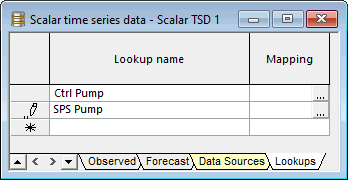

Lookup name
The name of the lookup table, as defined on the Lookups page.
Value offset
Offset value to be added to the data in the file.
Value factor
Multiplication factor to be applied to the data in the file.
Time Offset
Time offset applied to all the time series data time values sent to the engine.
The use of a time offset is mainly due to the way rainfall is recorded and how the InfoWorks ICM engine interprets rainfall. If there is a 15 minute rain data and a value at time T, this usually represents the rain that fell over the 15 minutes up to time T. This is the opposite in the engine, which applies rainfall at time T over the following 15 minutes.
Min. threshold
When importing (updating from external data source) any values below this threshold in external units will be marked as excluded. Also a message with the original value will be written into the Flag field of the Time Series Data Grid.
Max. threshold
When importing (updating from external data source) any values above this threshold in external units will be marked as excluded. Also a message with the original value will be written into the Flag field of the Time Series Data Grid.
Table
Name of the table in the telemetry database which contains the live data feed.
When using Simple CSV format as the data source type, this field can be used to specify the name of the file containing the live data feed if the file name does not match the Data Stream Name.
When using SANDRE (XML) format as the data source type, this field should be used to specify the XML filename (without path) to be processed. A wild card can be used in the filename e.g. prev_anduze_parfaite_*.xml so that times encoded in the filename do not prevent loading.
When using SOPHIE (Pre) format as the data source type, this field should be used to specify the name and location of the file containing the data.
When using PI WebAPI or EA RestAPI as the data source type, this is used to set which PI/EA "point" (or tag on a PI database) to get data from. The dropdown list will contain the first 2000 names from the server, however, if the required point is not included in the list then you can type it in.
When using the ADS Telemetry as the data source type, this field contains a list of locations retrieved from the ADS Telemetry web address (specified in the Server and Database fields), from which the applicable location can be selected.
Data column
Column in the table (specified in the Table field), that contains the monitored data values.
When using SOPHIE (Pre) format as the data source type, this field should be used to specify the station ID.
When using the ADS Telemetry as the data source type, this field will contain a list of entities retrieved from the ADS Telemetry web address (specified in the Server and Database fields), from which the applicable entity can be selected.
Time column
Column in the table (specified in the Table field), that contains the timestamp data.
Origin time column
Applies to forecast streams.
Column in the table (specified in the Table field), that contains the origin time data.
User field 1 to 3
When using SANDRE (XML) format as the data source type, User field 1 should be used to specify the filename of the transformation template used to extract the required data types (xsl format).
When using Jet, Oracle, SQL Server or ODBC data source types, the User field and User value fields are used to determine which values to get if the telemetry database contains data values for more than one stream.
Example
DateTime Value Feed Channel
01/01/2014 00:00 5 GaugeA Flow
01/01/2014 00:00 16 GaugeB Flow
01/01/2014 01:00 6 GaugeA Depth
01/01/2014 01:00 19 GaugeB Depth
To get the time series data for GaugeA set the following in the Observed or Forecast page of the TSD object:
Data column = Value
Time column = DateTime
User field 1 = Feed
User value 1 = GaugeA
To get only the flow time series data for GaugeA set the following also:
User field 2 = Channel
User value 2 = Flow
User value 1 to 3
When using SANDRE (XML) format as the data source type, User value 1 should be used to specify the data type e.g. Q (found in tag "GrdSerie"), and the station tag name e.g. B23600100101 (found in tag "CdCapteur") should be specified in User value 2.
When using Jet, Oracle, SQL Server or ODBC data source types, the User field and User value fields are used to determine which values to get if the telemetry database contains data values for more than one stream. (See User field 1 above for example.)
Tag name
Applicable to connections to PI, iHistorian and ClearSCADA databases.
Name of the tag in the database which contains the live data feed. A tag is a unique identifier for a data stream (or point).
Note: ICMLive requires the classic PI OLEDB provider and not the Enterprise OLEDB provider. Both providers can be installed side by side and do not interfere with each other. However, some of the functionality required by ICMLive is only available through the classic provider.
Description A description of the TSD object. This field could, for example, describe how the data streams were set up.
* indicates fields that are set at stream creation time and that cannot be modified afterwards.

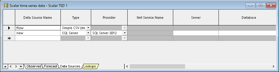

Data Sources page
Data sources are required to connect to external systems to get the time series data for the streams. For example the folder name where RADAR forecast data is stored or the connection string required for a RDBMS such as Oracle.
Note: Data sources are updated sequentially, so if the update of one data source is dependent on the update of another then it should be put before that data source in the list on the Data sources tab. This may occur, for example, if the scripts run third party models where the results of one model feed into another.

Data Source Name
User defined name for the connection.
Type
Dropdown list of supported database types:
  • JET
  • Note: It is not possible to use "access" as an external data source when carrying out automatic simulations using the Innovyze Live Server due to incompatibility of JET databases with x64 applications.
  • Oracle
  • SQL Server (SQL 2005 /2008 /2012 supported)
  • PI
  • PI WebAPI
  • ODBC
  • Note: ICMLive requires the classic PI OLEDB provider and not the Enterprise OLEDB provider. Both providers can be installed side by side and do not interfere with each other. However, some of the functionality required by ICMLive is only available through the classic provider.
  • Simple CSV (Deprecated)
  • Batch CSV
  • FW Format1
  • SOPHIE (Pre)
  • SANDRE (XML)
  • iHistorian
  • ClearSCADA
  • EA RestAPI
  • ADS Telemetry
Provider
Enabled when Type is set to SQL Server.
Available options are:
  • SQL Server 2005
  • SQL Server 2008
  • SQL Server 2012
Net service name
Enabled when Type is set to Oracle.
The name that was used to identify this particular Oracle database instance on your PC.
Server
Enabled when Type is set to SQL Server, PI, PI WDebAPI, iHistorian, ClearSCADA, EA RestAPI or ADS Telemetry.
Name of the server on which the telemetry database is stored.
For PI WebAPI and EA RestAPI, the connection is made using HTTP/TLS which defaults to port 443. If the server is configured to use a different port then ensure that this is entered as part of the server name e.g. "devdata.Innovyze.com:444".
For ADS Telemetry, this is the first part of the web address e.g. https://api.adsprism.com
Database
Enabled when Type is set to SQL Server , PI WebAPI or ADS Telemetry.
For SQL Server, this is the name of the telemetry database.
For PI WebAPI, this is the name of the PI data server.
For ADS Telemetry, this is the remainder of the web address. The specified Server and Database should provide the applicable ADS Telemetry URL.
Logon type
Enabled when Type is set to SQL Server, Oracle, PI, PI WebAPI, iHistorian or ClearSCADA.
Logon type can be:
  • Trusted - uses the Windows NT username and password as authentication when accessing the database

Lookups page
Some imported time varying data is received in alphanumeric text format, and in order for this to be recognised by InfoWorks ICM, it must be converted into numerical values. This conversion is carried out according to the mapping defined in a lookup table, which can subsequently be assigned to a data stream in the Observed and Forecast pages.
TSDB
Field Description
Lookup Name
User defined name for the lookup conversion table.
Mapping
Click to display the Live Data Lookup grid editor, which is used to map alphanumeric text to numerical values.
