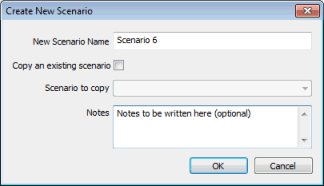

Create New Scenario Dialog
This dialog is displayed when you click:
Dialog description
Item
Description
New Scenario Name
The name for the new scenario.
Copy an existing scenario
If checked, the new scenario will be copied from an existing scenario.
Tip: Copying a scenario is very similar to the Copy / Paste operation in Windows. The copied scenario is a duplicate of the original scenario but is completely independent from it. See Important Note about the Structure of Scenarios for more information.
If unchecked, a new scenario is created from the base network.
Scenario to copy
Enabled if the Copy an existing scenario box is checked.
The scenario to copy from can be selected from a dropdown list.
Notes
Information about the new scenario can be specified here (optional).
OK
Commits the changes and closes the dialog.
Cancel
Cancels the changes and closes the dialog.
