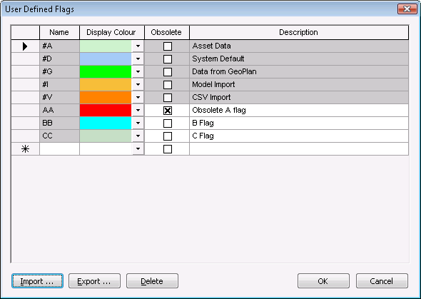

Create user defined flags
  1. Select Database managementUser defined flags from the File menu. The User Defined Flags dialog is displayed.
  2. Type in a four-character name to identify the flag. You must not include the # character.
  3. In the Description field, type a description of the flag.
  4. Double-click in the Display Color field. Select a colour from the palette. The program will use this colour to highlight data items associated with this flag.
  5. Click Close.
Importing and exporting flags to CSV
To export flags to a CSV file, click Export in the User Defined dialog. A standard File Save dialog is displayed. Choose where to save the flag data.
To import data flags stored in a CSV file, click Import. A standard File Open dialog is displayed. Select the file containing flag data. If a flag in the CSV file has the same name as a flag already in InfoWorks ICM, the imported flag will overwrite the existing flag.
To create a CSV file containing flags that can subsequently be imported, the file must have the correct format. The importer recognises the file as a flag file if it has the correct column headers in the first line. The colour value (fourth element in each line) is an RGB value.

Deleting flags
Only users with Administrator privileges can delete flags. Other users may mark flags as obsolete.
Flags can be deleted using the User Defined Flags dialog.
To delete flags
  1. Select the rows by clicking on the left hand end of the row.
  2. Click Delete or press Delete on your keyboard.
Note: The standard (#) data flags can never be deleted.
Obsolete flags
Users without Administrator privileges cannot delete data flags from the list, but can mark them as obsolete.
Flags can be marked as being obsolete by checking the Obsolete box in the User Defined Flags dialog. Data which already has an obsolete flag is still displayed with the flag, but the obsolete flag is not displayed in the list when editing a flag field. Therefore no new data items can be assigned the obsolete flag.
