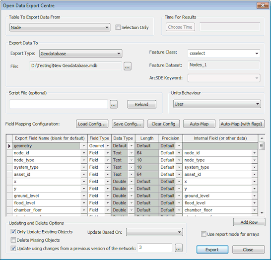

To export to a new Feature Class
- In the Open Data Export Centre Dialog select the InfoWorks ICM table to be exported from the Table To Export Data From dropdown.
- Select either the Geodatabase (an ESRI licence is required) or the File Geodatabase option from the Export Type dropdown in the Export Data To section.
Note: The File Geodatabase option is only available with 64 bit versions of InfoWorks ICM.
- Use the File browse button to search for an existing Geodatabase (or Feature Dataset). Alternatively, type in the path to the Geodatabase. Specification of a Feature Dataset is optional.
- Type in the Feature Class to be exported.
- Map InfoWorks ICM internal fields to Feature Class export fields by loading a configuration file or by manually mapping the fields in the Field Mapping Grid. (By default, object geometry will be exported to a field named FGeom. A user defined geometry field name may be specified by mapping a Field Type of Geometry.)
- Click the Export button.
InfoWorks ICM data will be exported to the specified Feature Class. If the Geodatabase (or Feature Dataset if specified) does not exist, it will be created and the Feature Class added.

- To update an existing Feature ClassIn the Open Data Export Centre, dialog, select an existing Geodatabase Feature Class via the File browse button in the Export Data To section. The Feature Class (and Feature Dataset if applicable) will be displayed in the dialog and the Updating and Delete Options section will become enabled.
- Map
Field Mapping Grid. In the Field Mapping Grid:
- Red indicates items in the Export Field Name column and Internal Field column that are mapped as update keys
- Italic font in the Export Field Name column indicates fields that do not exist in the selected Feature Class.
- The Export Field Name column contains a drop list of only the field names from the selected Feature Class. Entering a non-existent name specifies a new field name.
- To update the geometry of existing objects a Field Type of Geometry must be mapped.
- Map update keys - select the fields to be used to locate items for update in the specified Feature Class. The Update Based On dropdown list contains all update mapping options applicable to the current Table to be Exported:
- Asset ID - the Asset ID field is used to locate row objects in the specified Feature Class.
- InfoWorks ICM Primary Key Fields e.g. Node ID for node objects; US Node ID, Link Suffix for link objects. The Primary Key Fields are used to locate row objects in the specified Feature Class.
- Geodatabase OID or File Geodatabase OBJECTID - The field in the Internal Field column of the Field Mappings Grid with the Export Field Name of OID or OBJECTID is used to locate row objects in the specified Feature Class. Row objects where the value in the specified Internal Field matches the Geodatabase OID will be updated. If the Internal Field value of an object does not match the Geodatabase OID or File Geodatabase OBJECTID it will be treated as a new object.
- Set Only Update Existing Objects option:
- Check the Only Update Existing Objects box to restrict update to objects that already exist in the specified Feature Class. If this option is unchecked, any objects in the InfoWorks ICM table to be exported that do not match objects in the Feature Class will be added to the Feature Class.
- Set Delete Missing Objects option:
- Check the Delete Missing Objects box to search for missing objects and delete them from the target database at the end of the export process. (A missing object is an object that is in the external Data source table, but is NOT in the InfoWorks ICM Table to Export Data From.)
- The update key selected in the Update Based On dropdown will be used to search for missing objects.
- All missing objects found will be listed and a prompt for confirmation of deletion will be displayed before any objects are deleted.
Set Update using changes from a previous version of the network option:
Check the Update using changes from a previous version of the network box to compare the current version of the network with a selected previous version of the network. Differences in objects, identified by the comparison, will be applied to the external data table.
- Click the Export button to export data from InfoWorks ICM to the specified Feature Class. All fields, except mapped update keys will be updated in the Feature Class.
