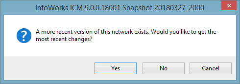

When you open a network that has changes that have been committed by others, but your local copy of the network has uncommitted changes, the following message is displayed:
Show me
Select:
- Yes to update your local copy of the network with the committed changes from other users and open it on the GeoPlan.
- No to open your local copy of the network on the GeoPlan without updating it to include the latest committed changes from other users.
- Cancels to cancel the open network operation.
