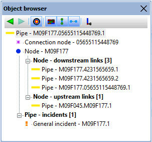

TreeView
The selected object which is identified by type and id is at the root of the tree.
The possible types of related objects are shown below the selected object. Relationship description is displayed in bold, with, in brackets, the number of objects within that relationship.
To expand a relationship group, click on the
button.
To expand further, click on the symbol adjacent to the related object. This will display relationships for the related object itself.
To open the object property sheet, double-click the adjacent symbol.

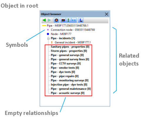

Related objects are grouped by relationship purpose - component, connected, associated and empty. See Object Relationships for more details.
Non-empty (i.e. component, connectedand associated) relationships are shown by default.
To view empty relationships, click the Show empty relationships button (
). To hide these relationships, click this button again (it is a toggle).
Additionally, displayed relationships can be restricted to a certain purpose (component, connected or associated, or any combination) of relationships by using the relevant toolbar button (Show component relationships / Show connected object relationships / Show associated object relationships, respectively). These buttons are all toggles therefore clicking on them again will hide Containing, connected and associatedrelationships respectively.
