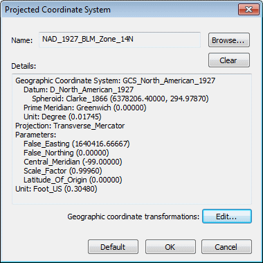

Select Set coordinate system from the GeoPlan menu to display the dialog.

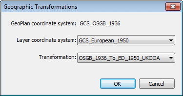

Click Edit to display the Geographic Transformations dialog. The dialog is used to specify geographic transformations to allow datasets which have different geographic coordinate systems to be mapped together.
