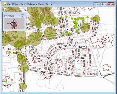

A new housing estate is planned in the south-east of an existing town. A feasibility study is to be carried out to assess options for connecting the new estate to the existing sewer network.
The base network is the network in its current state. The background map shows the plans for the new estate, and currently there are no nodes or links serving it:

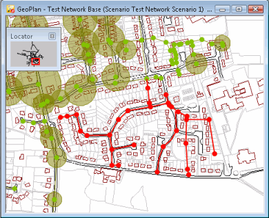

Scenarios can be used to model new estate connection options.
A scenario is created for each option to be assessed. An example is shown below:
