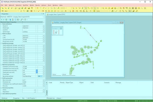

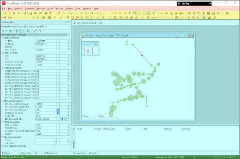

- Menus - A menu bar is included at the top of the program window, containing several menu options, which are usually grouped by functionality. The menu bar is highlighted in pink in the Show me an example of the workspace section
- Toolbars - The toolbars are usually found anchored at the top of the window and provide easy access to common functions. Toolbars are highlighted in yellow in the Show me an example of the workspace section.
- Main Window - Different windows or views can be displayed in the Main Window. The Main Window is where you can:
- Create and inspect details of the InfoWorks ICM database.
- Display various views or windows of your networks. For example, the screenshot in the Show me an example of the workspace section below, contains the GeoPlan View of the network as well as the Output Window. See the Windows section below.
- Produce graphs and reports.
The main window is highlighted in blue in the Show me an example of the workspace section.
- Status Bar - The bottom area of the InfoWorks ICM interface is the default location for the status bar, which provides additional information. The status bar is highlighted in green in the Show me an example of the workspace section.
An example of the workspace when using an Innovyze licence:
An example of the workspace when using an Autodesk licence:
Pink - Menu bar, Yellow - Toolbars, Blue - Main Window, Green - Status bar
