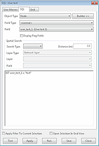

Using the SET Keyword
SET <assignment>
e.g.
SET user_text_1 = "text"
Sets user_text_1 field to text for all objects of the chosen object type (selected in the Object Type field of the SQL dialog).

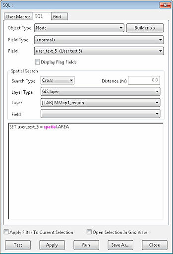

Example 2 Example
This will set the User Text 5 field of any nodes inside a GIS polygon in the GIS Layer "MMap1_region" to the value in the "Area" field of the GIS polygon.
See SQL and GIS Data for more information on including GIS Layers in SQL Queries.

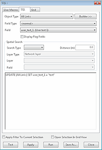

Example 1 Example
UPDATE <object type> SET <assignment>
e.g.
UPDATE [All Links] SET user_text_1 = "text"
Sets user_text_1 field to text for all link objects.
