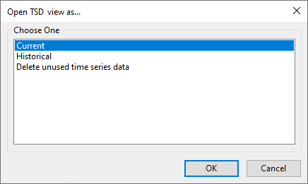

Open the current view of a Time Series Data object
  1. Right-click the relevant TSD object in the Explorer window, and select Open as from the context menu. The Open TSD view as dialog is displayed.
  2. Select Current from the list.
  3. Open TSD view as dialog
  4. Click OK. The current view of the TSD object is displayed (Observed or Forecast Page for Scalar TSD and Time Series Data Grid for Spatial TSD).
Open the historical versions of a Time Series Data object
    Note: If the TSD object is in a cloud database and the number of versions exceeds 10,000, a message is displayed warning you that it may take some to retrieve version information, and gives you the option to cancel the opening of this dialog. If you choose to open the dialog:
  2. Select Historical from the list.
  3. Click OK. The Select date for historical view of TSD dialog is displayed.
  4. Select the date and time to return to and click OK. The historical version of the TSD object corresponding to the date and time selected is displayed in read-only mode.
Delete historical data from a Time Series Data object
Note: Historical data used in runs cannot be deleted.
  1. Right-click the desired TSD object in the Explorer Window to display the Open TSD view as dialog.
  2. Select Delete unused time series data from the list.
    Note: This option is not available for TSD objects in cloud databases.
  3. Click OK. The Delete unused time series data dialog is displayed.
