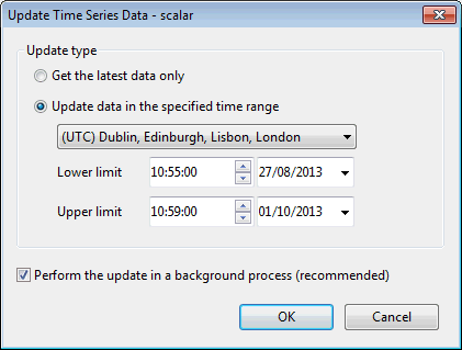

This dialog is used to configure settings for the manual update of time series data from external data sources.

Dialog description
Option Description
Update type
This section allows users to specify the type of update.
Get the latest data only- Select this option to perform a latest update ( optimistic update). When this option is selected the time zone, lower limit and upper limit controls are disabled (see below).
Update data in the specified time range - Enable this option to perform a ranged update ( pessimistic update ) based on the dates specified in the Lower limit and Upper limit fields. Selecting this option enables the following controls:
  • Time zone – Time zone to use for the time range specified in Lower limit and Upper limit. The default time zone is the machine time zone.
  • Lower limit – Defaulted to the current date and time.
  • Upper limit – Defaults to the current date and time.
See Updating Time Series Data for more information.
Perform the update in a background process (recommended)
Note: This option is not available when using an Autodesk - ICM Ultimate licence.
Checked by default.
When this option is checked, the time series data update will be executed in the background, as a server job. The Schedule Job(s) dialog, where schedule configuration takes place, will be displayed when the OK button is clicked on the Update Time Series Data dialog.
Tip: It is recommended that this option is checked as updates can be time-consuming and implementing them in the foreground may prevent users from carrying out other tasks on the computer.
Note: If Perform the update in a background process option is checked, then updating from an "access" external data source can only be done by selecting an agent that has a 32-bit version of InfoWorks ICM installed. If Perform the update in a background process is unchecked, updating from an "access" external data source can only be done in a 32-bit version of InfoWorks ICM. This is due to incompatibility of JET databases with x64 applications.
OK
Commit the changes and close the dialog.
Cancel
Abort the update and close the dialog.
