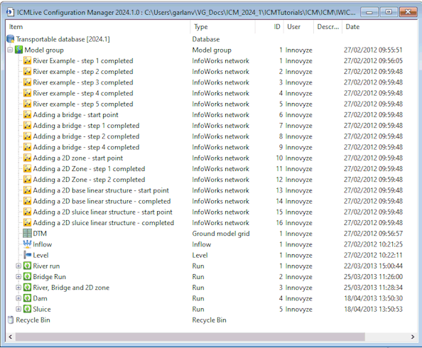

  3. Browse for the transportable database. This should be located in the ICM folder after the files have been downloaded and unzipped. Select the file (IWICM_Examples.icmt) and click Open.
  4. An Explorer window opens with the contents of the transportable database.
  5. The tutorial data is in the Model group. Click on the Tree plus button (expand) button adjacent to the Model group database item to expand its content:
    Explorer window with the transportable database containing the example data for the tutorials
Each network (Network icon) is a copy of the example data as it should appear at the start of each stage of a tutorial.
  • For example, the River example - step 3 completed network contains the network as it is expected to be at the start of step 4 of the River Tutorial.
  • Similarly, the Adding a bridge- step 2 completed network contains the network as it is expected to be at the start of step 3 of the Bridge Tutorial.
If the network for a particular step is missing (e.g. Adding a bridge - step 3 completed network is missing from the transportable database), it is because no changes were made to the network during that step, therefore a previous network can be used to continue the tutorial (in this case, the Adding a bridge - step 2 completed network can be used to go through step 4 of the Bridge Tutorial).

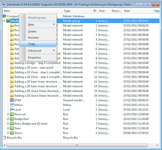

  4. Right-click on the top level of data you want to copy. For example, you can choose a whole model group (Model group group in our case) or any item in a model group (such as a network, a hydrograph or a simulation). Select Copy from the popup menu.
  5. Copying a database item

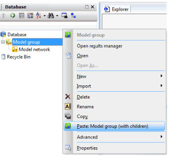

  6. In the Explorer view for the database to be copied to (your database), right-click on the item that is to contain the copied data and select Paste: nameofitem (with children) from the popup menu.
  7. Pasting database items
  8. If some of the items you are trying to copy are in the destination database, the Copying of Duplicate Items dialog is displayed.
    1. Click on OK to continue to paste the objects. Items that already exist in the database will be duplicated there and they are identifiable by the exclamation mark (!) that has been appended to the end of their name.
    2. Click on Cancel to abort the paste operation alltogether.
