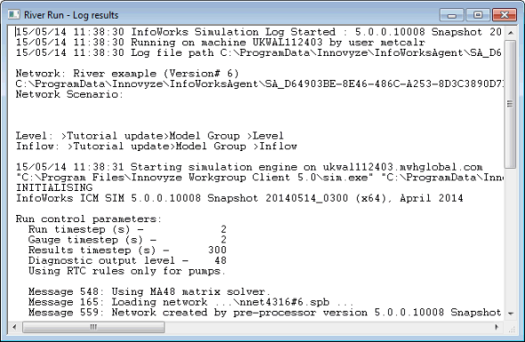

    3. Select Open As and either select the Log results (text) option or the 'PRN' summary results (text) (the PRN option shows you the raw data) and then click on OK.
    4. Text Results
    5. Use the scroll bars to move around the report and check for any messages that indicate that there may have been a problem with the simulation. If there are any problems in the simulation, the data it produces may not be reliable. After checking the log, close the window by clicking on the Close dialog button on the top right-hand corner.

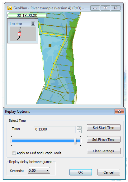

      3. Use the Play button (Play button) of the Replay Control toolbar to replay the simulation or the Jump / Replay button (Jump button) to select results for a particular time during the simulation.
      4. Jumping to a specific time of simulation

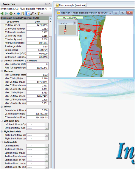

    3. You can use the Properties tool (Properties tool) to display the properties for a link or node.
      1. The Object Properties window now show the results for the selected object at the current timestep.
      2. Use the Jump / Replay button to advance the simulation to a particular time before clicking on the object.
      3. Results displayed in the Object Properties Window

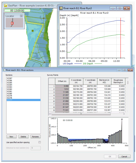

    4. You can display a graph of the effect of the simulation on various parameters for any point in the network. For example, you can view a graph of the flow through a particular link:
      1. Click on the Graph button (Graph button) on the Results toolbar and then on the B.1 link. A dialog is displayed, listing the parameters that are available.
      2. Select a parameter from the dialog (Depth in the screenshot below) and click on OK. The graph is displayed and can be resized. The vertical red line shows the current time in the simulation.
      3. You can then select the river reach in the GeoPlan with the Properties button (Properties button) and scroll through the sections on the dialog. Every cross section graph shows the water level at the current timestep.
      4. Analysing simulation results

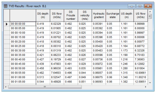

    5. You can hold down the CTRL key while clicking on a network object with the Graph button (Graph button) to display a grid of results for a particular link or node. Alternatively, you can use the Grid tool (Grid Results button) and click on the link. Close the grid when you have finished viewing the results.
    6. Grid results
