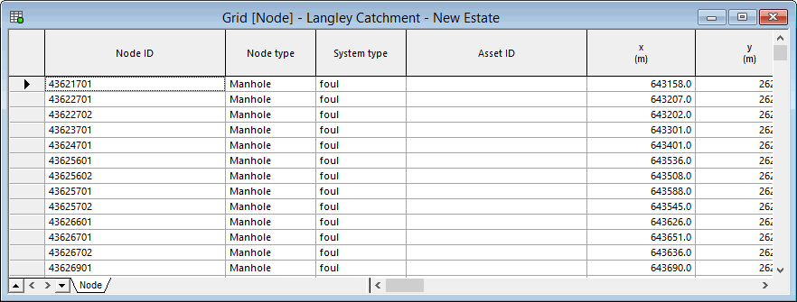

On the Grid View
- Click the
(New nodes window) button on the Modelling Grid Windows toolbar. Alternatively, select the Grid windows | New nodes window from the Window menu.
- Scroll the grid down until you reach the append row. The append row is marked with a * in the left column. If there is no append row, then the grid may be read-only.
- Type a unique name/identifier for the new node in the
Node ID column of the append row. As soon as you start to type the icon changes to
If you want, you can now add other parameters in the append row.
- To save the new node, move off the row you are editing by clicking another row in the grid. If the node name/identifier is not unique, a message will be displayed, and you can now change the
Node ID.
To abort the process, click the
button on the toolbar.
The Node Grid is now displayed.

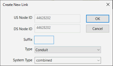

- Click the downstream node to complete the link, and the Create New Link dialog is displayed.
- Select the link type and enter a suffix if necessary. If you do not enter a suffix, InfoWorks ICM will create one for you.
- Select the System Type from the drop-down list.
- Click OK.
The new link is created and displayed on the GeoPlan. The property sheet for the new link is displayed. You can enter additional properties now or later. If you change any link properties, click OK to save them. You can click Cancel to exit the property sheet without making any changes. The new link will not be removed.

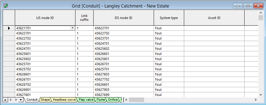

On the Grid View
- Click the
(New links window) button on the Modelling Grid Windows toolbar, and select the New links window option from the drop-down list . Alternatively, select the Grid windows | New links window from the Window menu.
- Click the appropriate tab.
- Scroll the grid down until you reach the append row. The append row is marked with a * in the left column. If there is no append row then the grid may be read-only.
- Select the names/identifiers for the upstream and downstream nodes from the drop-down list in the appropriate columns in the append row, or you can type in names/identifiers for nodes you have not yet created. You may also need to add a unique suffix for the new link. As soon as you start to type the icon changes to
. You can add other parameters to the append row now if you want.
- To save the new link, move off the row you are editing by clicking another row in the grid. If the combination of upstream node, downstream node, and suffix are not unique, a message will be displayed. You must type in a unique set to identify the link.
(Undo) button on the toolbar.
The New Grid is now displayed.
The properties for each type of link are contained in a separate tab at the bottom of the grid.

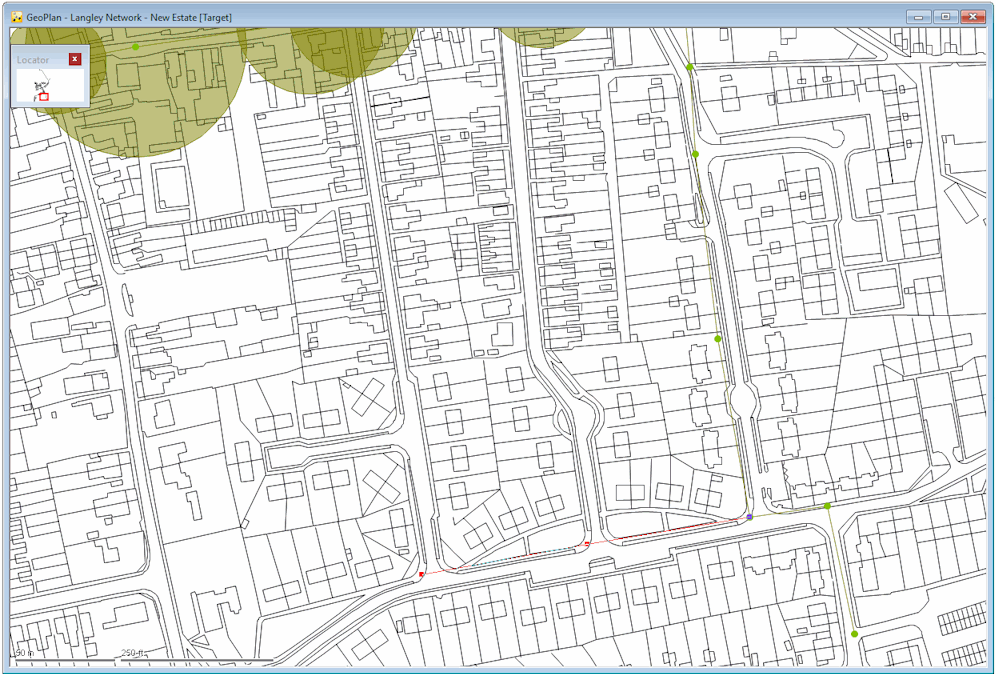

Example of Adding Nodes and Links
To add nodes and links to the example network:

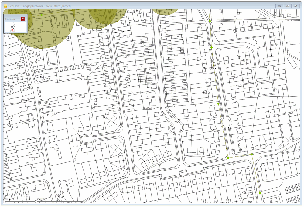

- Open the 'Langley Network - New Estate' network.
- Display the background map if it is not already displayed. Right-click the GeoPlan, select the GIS Layer control option from the context menu, click 'MapC' in the GIS Layers list, add a check in the Visible box and click OK.
- Check the length of the required run:
- Zoom in on the road where the pipes are to be added. You can, for example, use the Find in GeoPlan option in the GeoPlan menu to zoom onto the required road. In the dialog, enter the node id, in this case, 44628202, and click the Find button, and the GeoPlan will be centred on the specified node which is located at the start of the run.
- Use the
(Measure distance) tool to estimate the total length of the new run. Click node id, '44628202' and then click each of the intermediate points along the street where a bend may occur. The cumulative distance is displayed in the status bar.
- Add nodes at each of the three road junctions:
- Select the
option from the drop-down list on the GeoPlan Tools Toolbar.
- Click the
(New object) button on the toolbar.
- Click in the centre of the first road junction, and the Create New Node dialog is displayed.

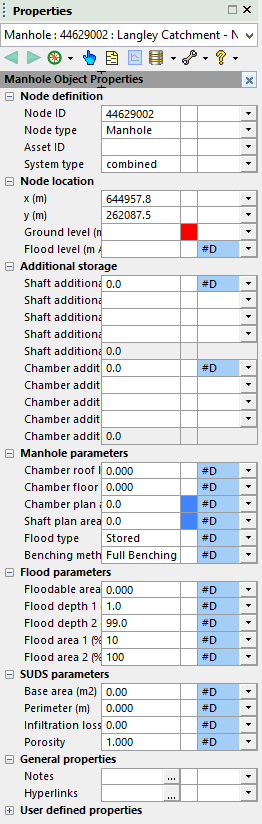

- Enter '44629002' as the
ID and click
OK. The Node property sheet is displayed in the object properties window.
- Repeat steps 4c and 4d for the other two junction, using '44629003' and '44619904' as the node ids.
Note that required data (highlighted by red flags in the property sheet) such as Ground level can be added later.

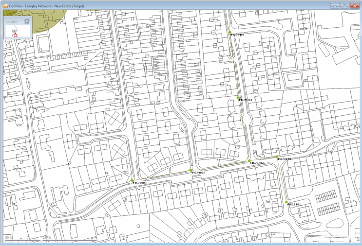

- Select the
- Connect up the nodes:
- Select the
- Click the
button on the toolbar. The cursor changes to
on the GeoPlan.
- Click the starting point for the link (i.e. the node at the start of the run, in this case, node '44628202')
- Click the road halfway between the nodes to create a bend in the link.
- Click the node at the end of the link (node '44629003'), and a Create New Link window is displayed.

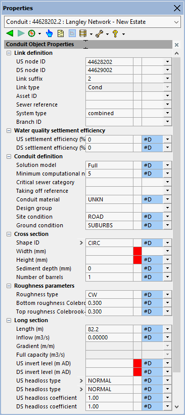

- Click OK and the conduit property sheet is displayed in an object properties window.
- Repeat steps 5c to 5f to add the two other links, including "link bends" where necessary, to complete the links between nodes '44629003' and '4469002'.
If you do not specify a Suffix, InfoWorks ICM will automatically allocate one.
Note that required data (highlighted by red flags in the property sheet) such as Width can be added later.
- Select the
- Commit the changes to the network, without validation.
- Close the GeoPlan view by clicking the
button in the top right-hand corner of the window.
There are pipes running behind the houses on the east of the estate. However, a pipe is also needed along the road that runs down eastward of the estate, with manholes at each of the two road junctions (node id '44628202').
