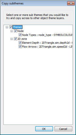

This dialog is used to copy themes across object layers, and is displayed when you click Copy () Copy + (copy) on the Layers and Themes page of the GeoPlan Properties dialog.
The dialog shows a list of currently visible themes, and any other themes that have been set up for the network during the current InfoWorks ICM session.
Example of Copy subthemes dialog in InfoWorks ICM
  • Check the box next to every theme you want to copy.
  • Click OK.
