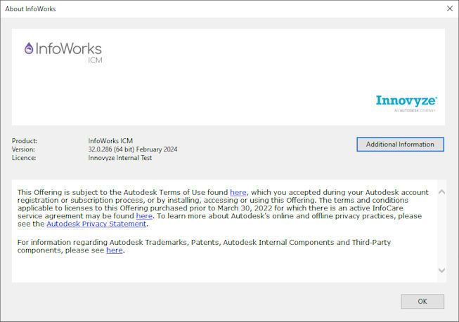

The About InfoWorks box displays usage agreement information about your current InfoWorks ICM installation, as well as the version build number of the installed software and the licence name (if applicable), which is read from the server.
The About Box is displayed by selecting About InfoWorks from the Help menu.
An example of the About InfoWorks box when using a licence supplied by Innovyze:

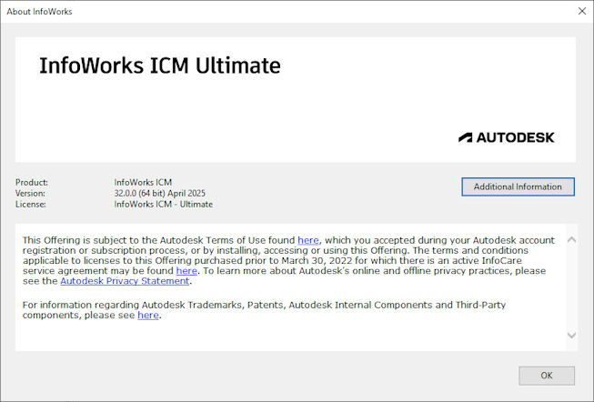

An example of the About InfoWorks box when using a licence supplied by Autodesk:

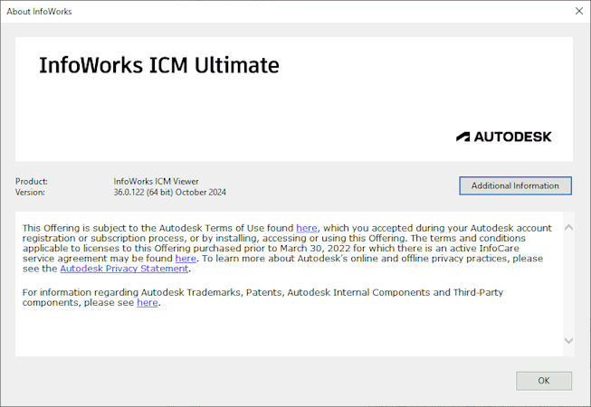

An example of the About InfoWorks box when using the Autodesk InfoWorks ICM Viewer.
