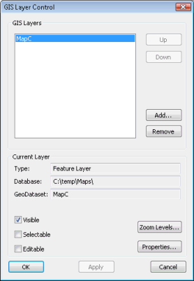

ArcGIS Engine GIS Layer Control dialog

Use this dialog to choose how layers are displayed on the GeoPlan Window when using ESRI ArcGIS Engine, ESRI ArcGIS Desktop or Precisely MapXtreme .NET as the GIS component.
All layers can be moved up or down in the display order, added and removed, or temporarily hidden without removal. The layer can also be hidden automatically when the zoom level moves outside a certain range.
The GIS Layers box lists the layers that are currently loaded on the GeoPlan. The layers are added to the view in the order shown, with the layer at the top of the list being displayed above all other layers.
The following buttons change the layers that are displayed:

Add... |
Adds a new layer. |
Remove |
Removes a layer from the display (the data is unaffected). |
You can change the following properties of the display for each layer:
Projection |
Only available for shape files when MapXtreme is the current map control. Click on the
This option is not likely to be used very often but provides the user with a means of changing the projection system if the one originally associated with the layer has not been correctly interpreted by InfoWorks ICM. |
Visible |
The layer is visible. |
Selectable |
Items in the layer can be selected. (WMS layers and ArcGIS Server Map layers can not be made selectable). |
Editable |
The underlying data in the layer can be edited on the GIS Layer Information Dialog if this box is checked. See Viewing and Editing GIS Layer Data for more details. (WMS layers and ArcGIS Server Map layers can not be made editable). Note: ESRI ® Shape files (.shp) are not editable (Read-only Editable check box) when MapXtreme is the current map control.
Zoom Levels... or Map Scales... |
Displays the Layer Visibility dialog, where the user can specify the level range over which the GIS layer is to be applied. |
Properties... |
Clicking the Properties... button will display the Layer Properties Dialog. This allows you to change symbol shape, size and colour for the current layer. Note: The above does not apply to WMS layers or ArcGIS Server Map layers.
If the layer in the current row of the list is a WMS layer, clicking the Properties... button will display the Web Map Service Properties Dialog. This dialog provides detailed information about the Web Map Service and allows the visibility of layers to be edited. If the currently selected layer is an ArcGIS Server Map layer, the Properties button will be disabled. Use your GIS software to view properties of ArcGIS Server Map layers. |
