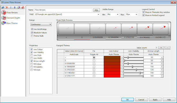

Continuous. Displays objects differently based on a series of ranges of a parameter. Suitable for parameters with continually variable values, such as depth or flow.

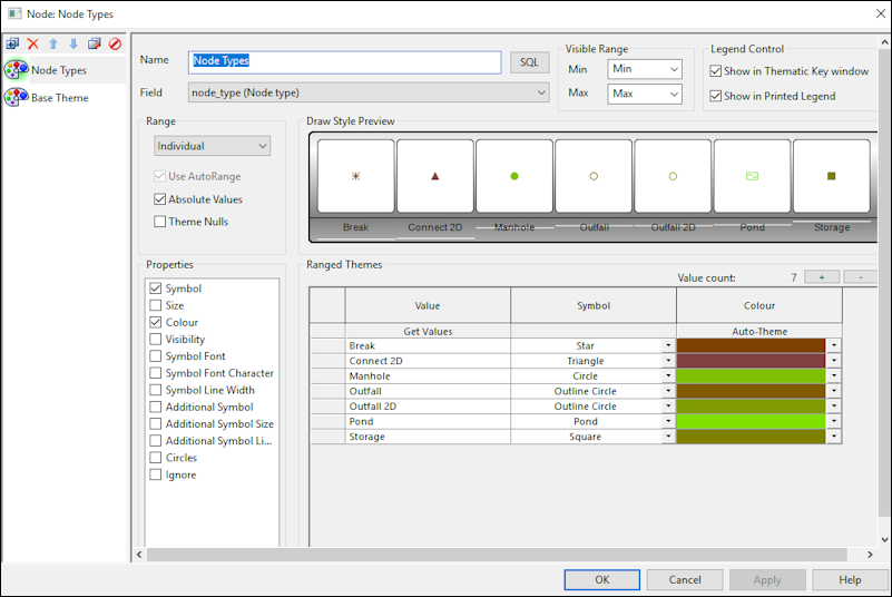

Individual. Displays objects differently based on individual values (rather than ranged values) of a parameter. Suitable for parameters with a small number of discrete values.
Direction. Only available for 2D results fields with directional (angle) parameters such as, sim.minangle2d (Direction at first min velocity), and displays objects based on degree ranges.
Flag. This is a special case of the Individual settings where the discrete value being displayed is the data flag.
Use AutoRange - With this option checked, InfoWorks ICM automatically re-scales the values if you open a different network or simulation.
Relative Palette - InfoWorks ICM will apply the selected set of colours in the Ranged Themes Grid to the area currently being viewed on the GeoPlan. Values are automatically re-scaled when the GeoPlan zoom is changed. (Applies to Flood, Ground Model and Rainfall themes.)
Absolute Values - Removes any sign and simply uses the absolute value of the parameter. Ideal for flow or velocity to remove the effect of direction. For example, flow will be negative if it is from the downstream to upstream end of a pipe in a simulation. This negative value would probably be misleading in a theme.

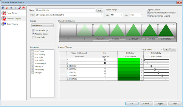

  • Plus and minus buttons ( ) - respectively add or remove values within the range; hold the button down to add or remove multiple values. The number of ranges is displayed next to the buttons. When values are added, these are calculated according to the distribution type that has been selected (see below).
  • Value column: Either use the values automatically set up by InfoWorks ICM or fill in the values you need manually.
  • Autoscale button (Unavailable for choice lists such as node type, for example). Click to apply a different type of distribution for the values. Click on the button until the desired distribution is obtained. Use in conjunction with the cumulative frequency histogram displayed in the Draw Style Preview to select a suitable distribution. Available distribution types are:
    • Linear (default)
    • S curve
    • N curve
    • Exponential - (useful if most of the parameter values are in the low end)
    • Log - (useful if most of the parameter values are in the high end)
    For a Direction range setting, the AutoScale function automatically scales the values to provide a complete range; -180 degrees (West) through -90 degrees (South), 0 degrees (East) and 90 degrees (North) to 180 degrees (West again).
  • Fix column - Check this box to fix the value of the range to the current value. When fixed, this value will not change when the value column is scaled (When the Use AutoRange check box in Range is ticked).
    It is possible to fix/unfix all the values at once, by using the Toggle All button (see below).
    • Toggle All - click this button to turn on/ off the fix for all the values of the range at once.
    Note that the Fix column is not available for Direction ranges.
  • Available attributes - these are listed in the sections below. Use the check boxes and the dropdown boxes to set up the sub theme.
    • Auto-Theme button - this button is very similar to the Autoscale button for the Value column. It is particularly useful if you have added intermediate values by using the Plus button at the top right-hand corner of the Ranged Themes section ( buttons). Set a value for the top and bottom property settings in the grid and then click the Auto-Theme button so that the software interpolate between the low and high values to create a graduated distribution. For properties relating to colour, clicking again on this button cycles through different ways of traversing the colour space between the high and low value.

Point / Node theme attributes
Attribute
Description
Symbol
Check the box to use a symbol other than the default setting (circle).
Select the desired symbol for each value in the corresponding dropdown list.
Symbol size
Check the box to use a symbol size other than the default setting (60).
Select the desired size for each value in the corresponding dropdown list.
Symbol colour
Check the box to use a symbol colour other than the default setting (black).
Select the desired colour for each value in the corresponding dropdown list.
Symbol visibility (%)
Check the box to use a visibility other than the default one (100%) for the symbol.
Use the slider to control the symbol visibility for each value (Slider at the left end indicates 0% visibility whilst slider at the right end means 100% visibility).

Arrows
Check the box to use arrows in the theme.
Select the desired number of arrows for each value in the corresponding dropdown list.
Arrow Style
To be used in conjunction with the Arrow property.
Check the box to use arrow styles in the theme.
Select the desired style (-->-- or <--->) for each value in the corresponding dropdown list.
Tip: Note that end arrows always point outwards irrespective of the sign on the arrows count. Also, when multiple end arrows are used, the heads work backwards from the line end.

Polygon theme attributes
Attribute
Description
Symbol
Check the box to use a symbol other than the default setting (None).
Symbol size

Special polygon themes for 2D zones
2D zones have two special themes that are provided by default:
Note: Both themes are disabled by default. This is identifiable by the greyed out palette with the disabled icon () overlay in front of their name in the Sub Theme Manager Pane. To enable these themes, select them in the Sub Theme Manager Pane and click on the Enable / Disable button () on the toolbar.
  • Flow arrows or 2D arrows. This theme uses arrows with varying lengths as indicators of the velocity in a mesh element (The field mapped is 2DTriangle.sim.speed2d - speed2d) during replays of a simulation. Arrow length, line colour and visibility have been auto-themed, i.e. lowest and highest values have been set and intermediate values have been interpolated.
  • Depth or 2D triangles - this theme uses the fill colour and visibility of 2D triangles as indicators of flood depth within the triangles (The field mapped is 2DTriangle.sim.depth2d - depth2d) during replays of a simulation. Fill colour and visibility have been auto-themed.
2D Zone attributes
For 2D Zones with results, the following attributes can be used in a theme to provide, for example, arrows scaled by speed and oriented by direction.
Attribute
Description
Arrow Length
Check the box to use an arrow length other than the default setting (100).
Select the desired length for each value from the corresponding dropdown list.
Arrow Angle
Check the box to use an angle for the arrow other than the default setting (0).
Use the slider to control the arrow angle for each value.
Tip: When using this property with a Direction range setting, a larger the value count will provide a higher degree of accuracy when Autoscaled.
Tip: The Auto-Theme button (see Sub Theme Editor Pane section), which is available for most of the attributes, interpolates between set low and high values for the range and generates graduated intermediate values for the values in-between.
