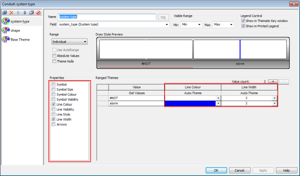

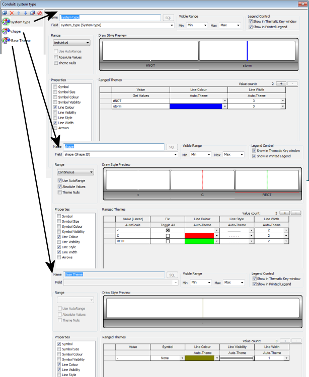

If we consider the example of 2 conduit sub-themes for system type and shape , for which attributes or properties are shown in the screenshot below:
For better clarity, the properties have been summarised in the table below:

system type
not set
storm - blue
#NOT - white
not set
not set
3
3
shape
not set
CIRC - red
RECT - green
dotted line
dotted line
not set
2
2
base theme
(default theme)
none
Khaki
not set
100%
1
system type sub-theme takes precedence for the line colour and line width attributes. As no line style has been configured for system type, the next sub-theme down that has settings for this property takes precedence, which is shape . This means that the line style will be dotted on the GeoPlan. Similarly, as neither system type, nor shape have had the symbol and the line visibility properties specified, the values that will prevail are the ones of the next theme down, which is the base theme in our case (none and 100% respectively).
Now, if we look at the system type and conduit shape distinction, the current setup means that all conduits of system type storm will be displayed in thick dotted blue lines, regardless of their shape whilst conduits of any other system type will be shown in thick dotted white lines, also regardless of their shape . This shows that the current shape sub-theme is not being effective at all and perfectly illustrates the property override mechanism.

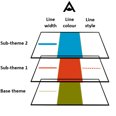

The image below illustrates how the cascading styles work if we over-simplify our example to the extreme. If we consider that each sub-theme is a transparent sheet of paper with properties on it and if we look at the superimposition of themes from the top, it can be seen that the resulting theme will have the line width and colour attributes of sub-theme 2 and the line style of stub-theme 1. Sub-theme 2 has no line style property set, therefore it is the next "visible" configuration of the line style attribute that will take precedence.
