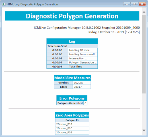

HTML log files
The layout and appearance of HTML log files produced by InfoWorks ICM has been improved.
An example of an ICM log file which is generated using the Create diagnostic polygons option is shown below:
