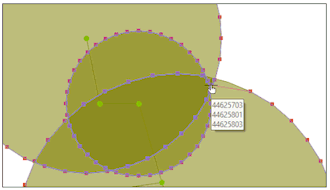

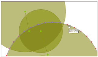

Snapping mode
When the snapping mode is on, and a vertex being moved becomes close to other objects that it can snap to, the vertices in the adjacent objects, including any overlapping ones, will now also be highlighted. This helps, for example, to position a vertex being moved more precisely.
Before: Only vertices in object being moved were highlighted Now: Vertices in adjacent 'snappable to' objects are also highlighted
