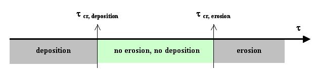

The idea of the deposition – erosion criterion based on shear stress is that if the actual shear stress θ is below the critical shear stress value for deposition θcr, deposition, i.e. if θ < θcr, deposition, then deposition will occur. If the actual shear stress value θ is in-between the critical shear stress value for deposition and the critical shear stress value for erosion, i.e. if θcr, deposition < θ < θcr, erosion, then no erosion or deposition will occur and all suspended sediment is transported along the conduit. If the actual shear stress θ exceeds the critical maximal shear stress value for erosion θcr, erosion, i.e. if θ > θcr, erosion, then erosion will occur.
Figure 1: Illustration of the deposition – erosion criterion based on shear stress

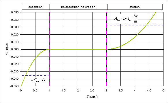

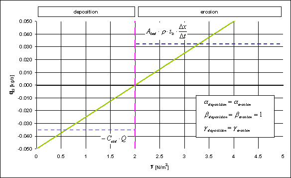

Six user editable parameters are introduced, three of which (αdeposition [kg/s] ; βdeposition [-] ; γdeposition [-]) apply to deposition processes and three of which (αerosion [kg/s] ; βerosion [-] ; γerosion [-]) apply to erosion processes. An example of the application of these six parameters is shown in figure 2. Figure 3 shows an example of the deposition – erosion criterion in its most simple form, i.e. when αdeposition = αerosion, βdeposition = βerosion = 1 and γdeposition = γerosion.
Figure 2: Example of the deposition – erosion rate criterion representing the deposition – erosion rate qs as a function of the shear stress θ
Figure 3: Example of the deposition – erosion criterion in its most simple form representing the deposition – erosion rate qs as a function of the shear stress θ
