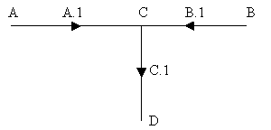

Consider a T junction like this:
Figure 2 T Junction 1
If 0% of the flow comes from B.1, then the headloss coefficient at the top of C.1 would be 6.6 (a 90 degree bend.) If any flow comes from B.1 then it is suggested that the headloss should be increased. Work out the proportion of flow likely to come from B.1 based simply on the relative diameters of the pipes, as shown in the Table 2 below.
Link Number |
Diameter (mm) |
Area (m2) |
Proportion |
A.1 |
575 |
0.260 |
0.62 |
B.1 |
450 |
0.159 |
0.38 |
Table 2 Proportion of Flow
Therefore the total headloss at the upstream end of C.1 would be:

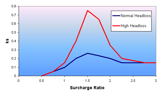

3.1.1 Surcharge Ratio Coefficient (ks)
The surcharge ratio coefficient defines the relationship between headloss and the depth of flow in the pipe:
Flow depth is defined as the level in the node, minus the invert level of the pipe (immediately up or downstream of it.)
The relationship between surcharge ratio coefficient (ks) and surcharge ratio is presented in the InfoWorks on-line help and in Figure 4 below.
Figure 4 Normal and High Headloss Coefficients
For both the Normal and High headloss conditions, it can be seen that headloss is negligible when the pipe is less than half full and at a maximum at levels just above pipe full.
For these two headloss conditions InfoWorks automatically assumes that the flow is less turbulent at the downstream end of a conduit. It therefore applies a coefficient of –0.1 to the downstream headloss values. The value is negative for reasons described at the start of this section.

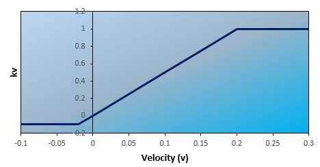

3.1.2. Velocity Coefficient (kv)
The velocity coefficient defines the relationship between headloss and velocity. It is based on the direction of flow with respect to the name of link. The relationship between kv and v for all values of v is presented in Table 4 below.
V |
kv |
< -0.02 |
0.1 |
-0.02 to 0.2 |
-0.1 + (v – ( -0.02)) * (1.0 – (-0.1)) / (0.2 – ( -0.02)) |
> 0.2 |
1.0 |
Table 4 Relationship Between kv and v
This relationship is also presented in Figure 5 below:
Figure 5 Relationship Between kv and v

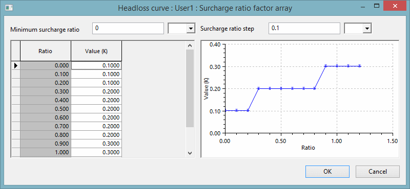

3.3 User Defined Headloss
User defined headloss allows the user to specify a relationship between surcharge ratio and ks and between velocity and kv.
This is achieved by opening the network links grid and then selecting the headloss curve tab. Enter a new Headloss ID and then double left click on it (the Headloss ID name) to display the property sheet for the headloss curve. Figure 6 below presents an example user defined ks against surcharge ratio relationship. Using this example, any conduits with an up or downstream headloss type of 'User1' would utilise the defined relationship.
Figure 6 User Defined Headloss Coefficients

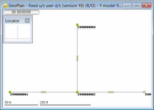

Figure 7 Example Network
Figure 7 above shows a simple three pipe network. 0.18 m3/s was applied to nodes SV00000001 and SV00000004. Figure 8 below shows a long section from SV00000004 to SV00000003 including the headloss conditions and hydraulic results.
- Pipe SV00000002.1 is 2 m wide.
- Q = 0.36 m3/s
- d = 0.116 m
Example 1 Flow Area Calculations

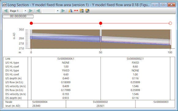

In this first example, the 'Use full area for headloss calculations' box in the simulation parameters is not ticked and therefore the area of the flow is used in the calculations.
v = 0.36 / (2 x 0.1164) = 1.546 m/s. This matches the results presented in Figure 8
v2/2g = 0.122
Upstream headloss coefficient = 6.6
headloss = 6.6 x 0.122 = 0.805 m
The upstream invert level is +28 m AD.
Therefore level in node SV00000002 =
28 + 0.1164 + 0.805 = 28.921, which matches Figure 8.
The velocity in the downstream end of pipe SV00000004.1 is only 0.1929 m/s, due to the increased depth in this pipe.
v2/2g = 0.0019
headloss = 6.6 x 0.0019 = 0.012 m
depth in the downstream end of pipe SV00000004.1 =
28.921 – 28 + 0.012 = 0.933 m, which again matches Figure 8.
The downstream headloss coefficient in pipe SV00000001.1 is 1.0, therefore the downstream depth in this pipe is 0.923 m.
Figure 8 Example 1 Results

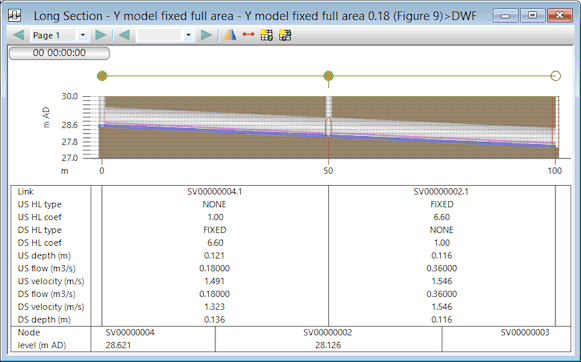

Example 2 Pipe Full Area Calculations
In this second example, the 'Use full area in headloss calculations' box in the simulation parameters is ticked and therefore the area of the pipe is used in the calculations.
v = 0.36 / (2 x 1) = 0.18 m/s.
This is the value used only in the headloss calculations and does not match the velocity results presented in Figure 9. This is not a mistake, it’s the way it’s meant to work.
v2/2g = 0.0016
headloss = 6.6 x 0.0016 = 0.010 m
28 + 0.116 + 0.010 = 28.126, which matches Figure 9.
Pipe SV00000004.1 is 1 m x 1 m.
v = 0.18 m/s.
the headloss here is also 0.010 m.
28.126 – 28 + 0.010 = 0.136 m, which again matches Figure 9.
Figure 9 Example 2 Results

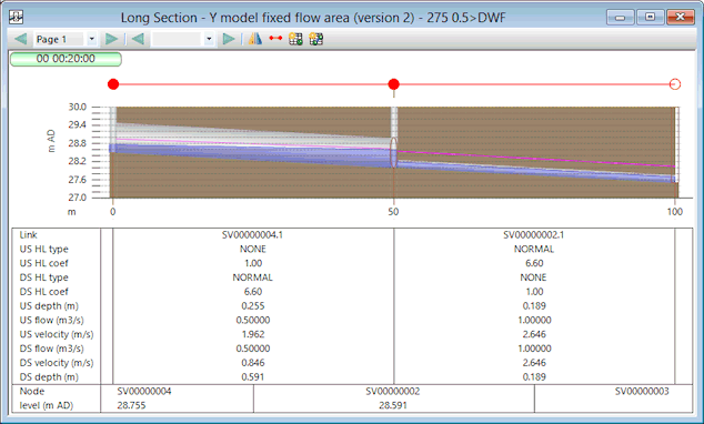

Example 3 Flow Area Calculations, Normal Headloss
When normal headloss is applied, headloss is calculated from equation 1, represented below.
In this example, the height of pipe SV00000002.1 was reduced to 275 mm, in order to create a reasonable surcharge ratio.
v = 2.646 m/s
v2/2g = 0.357
Pipe height = 275 mm, water level in node = 28.591 therefore surcharge ratio = (28.591 – 28.000) / 0.275 = 2.15
Therefore from interpolation of graph
ks = 0.172
velocity > 0.2 m/s therefore kv = 1.0
ku = 6.6
therefore headloss = 0.172 x 1.0 x 6.6 x 0.357 = 0.405 m
InfoWorks gives level in node – pipe invert level – depth in pipe =
28.591 – 28.00 – 0.189 = 0.402 m
Figure 10 Example 3 Results
